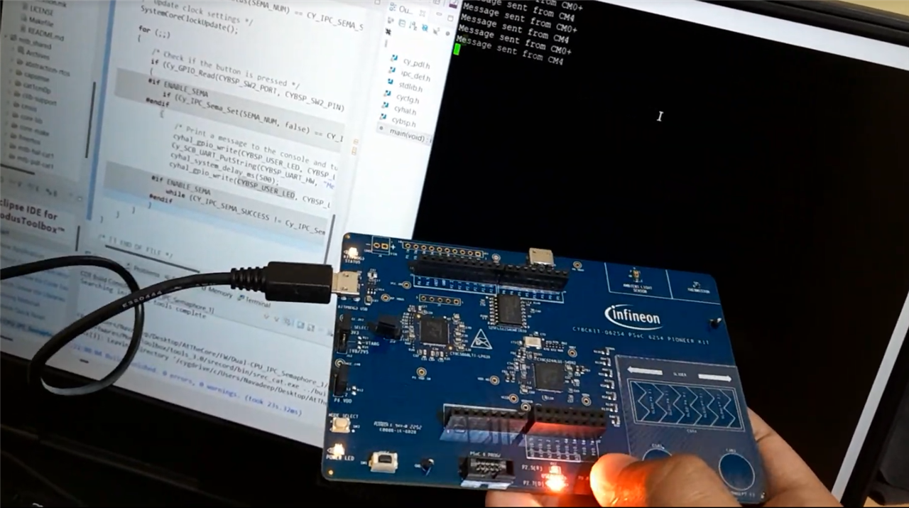

Strating off with, I tried inter-process communication using semaphore. misaz 's roadtest post was a good reference there and I tried out what Jan Cumps mentioned about disabling the semaphore and seeing the chaos happen.
Next, I used the onboard ALS and Temperature sensors to get the data printed through UART with IPC on with the same game, but additional computations over CM4+ to acquire sensor data and stream out. This involved calling the UART print function inside the main for loop of CM4 side after enabling the semaphore and same remains on the CM0+ side. Checking if the button is pressed -> Enabling the semaphore -> Turning user LED ON -> UART Print -> Disabling the semaphore.

CM4 side
        if (cyhal_gpio_read(CYBSP_USER_BTN) == CYBSP_BTN_PRESSED)
        #if ENABLE_SEMA
            /* Attempt to lock the semaphore */
            if (Cy_IPC_Sema_Set(SEMA_NUM, false) == CY_IPC_SEMA_SUCCESS)
        #endif
                /* Print a message to the console and turn Orange LED ON*/
                cyhal_gpio_write(CYBSP_USER_LED2, CYBSP_LED_STATE_ON);
                printf("Message sent from CM4\r\n");	/*UART transmit message*/
                /*Also send sensor data*/
    			/* Wait till printf completes the UART transfer */
    	        while(cyhal_uart_is_tx_active(&cy_retarget_io_uart_obj) == true);
				/* Print the temperature and the ambient light value*/
				printf("Temperature: %2.1lfC    Ambient Light: %d%%\r\n", temperature, light_intensity);
				printf("\n");
                cyhal_system_delay_ms(1000);
                cyhal_gpio_write(CYBSP_USER_LED2, CYBSP_LED_STATE_OFF);
            #if ENABLE_SEMA
                while (CY_IPC_SEMA_SUCCESS != Cy_IPC_Sema_Clear(SEMA_NUM, false));
            #endif
CM0+ side
for (;;)
    /* Check if the button is pressed */
    if (Cy_GPIO_Read(CYBSP_SW2_PORT, CYBSP_SW2_PIN) == 0)
    #if ENABLE_SEMA
    #endif
            /* Print a message to the console and turn Red LED ON */
            cyhal_gpio_write(CYBSP_USER_LED, CYBSP_LED_STATE_ON);
            Cy_SCB_UART_PutString(CYBSP_UART_HW, "Message sent from CM0+\r\n");		/*UART transmit message*/
            cyhal_gpio_write(CYBSP_USER_LED, CYBSP_LED_STATE_OFF);
        #if ENABLE_SEMA
        #endif
