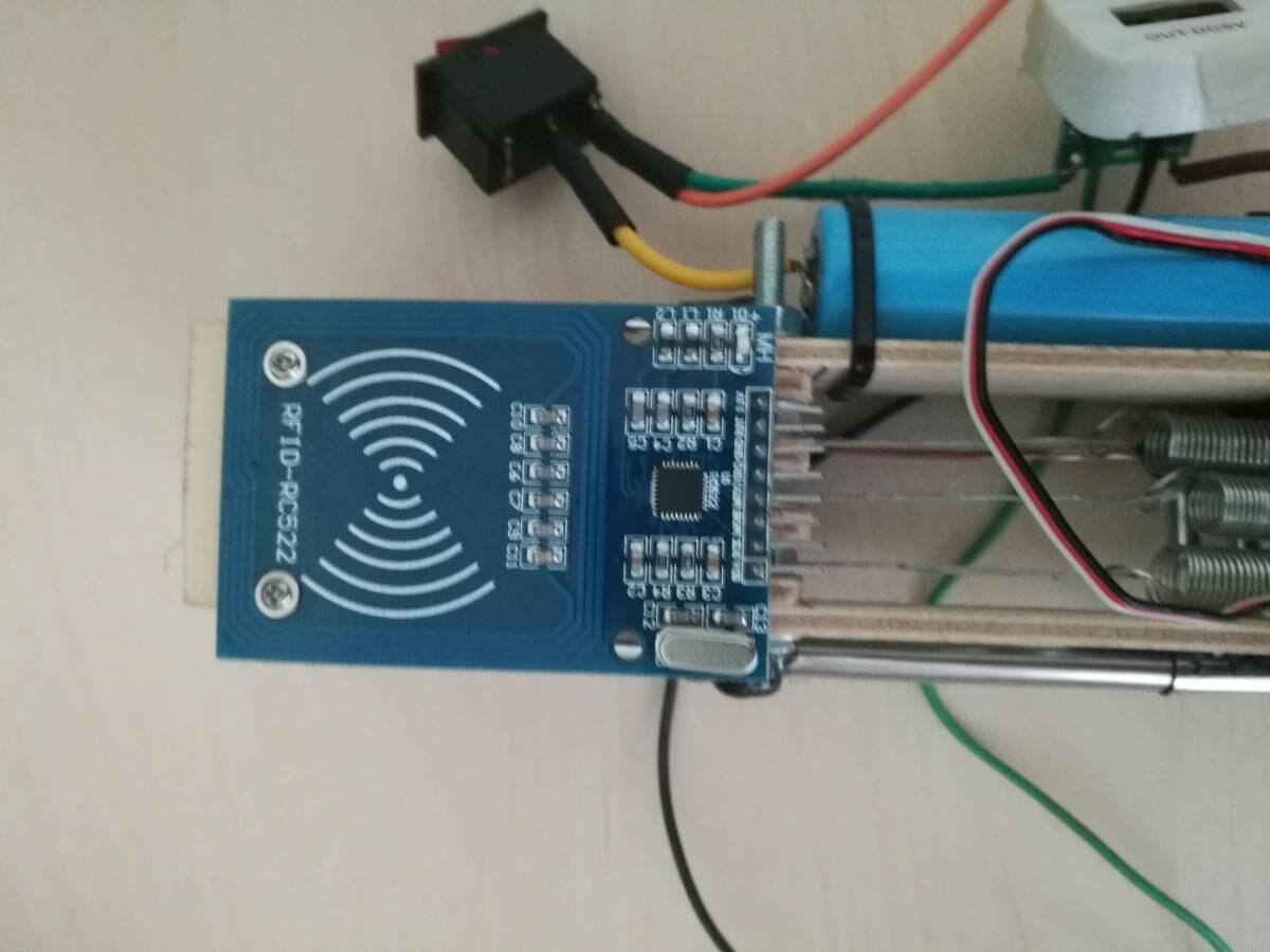

Assembly
Now that we know everything is working as it should, all that's left is to mount everything onto the device piece by piece, while this sounds much easier than the coding, it turned out way harder in fact. This is the last day for project submissions so I didn't have time to desolder all of the pins from the Arduino, so I stick with them and used jumper wires, which unfortunately made the device unusable with only one hand. Here are some of the pictures of how the assembly went.
{gallery} Assembly
Battery: The battery fit perfectly on the side of the spring holder and I glue the charging circuit right behind it
RFID module: I mounted the RFID module on the bottom plate of the key holder, since it's the easiest to put against a tag that's attached to a door
Arduino: I had to mount the Arduino on the other side of the spring holder, there really wasn't any suitable space for that would leave the connectors free for me to connect the wires
Fingerprint module: I mounted the fingerprint module also underneath, next to the RFID module
Wires: A giant bulk of wires on top of the Arduino, there is nothing I can do for this since this is all dependant on the position of the Arduino. A little cable management would help a little, but I don't want to risk bending any of the wires and damaging anything in the process
Charging circuit: The charging circuit fit snugly next to the servo without causing any issues to the movement of the servo
That would be it for the assembly. I would say it went smooth, but I was doing it in a really big hurry so I had a few problems along the way. The biggest one being using the wrong wire from the fingerprint module, and completely forgetting to connect the ground wire to the buzzer, but when I sorted out those things, everything worked as it should. All that's left to do is test it out and that would be it.
