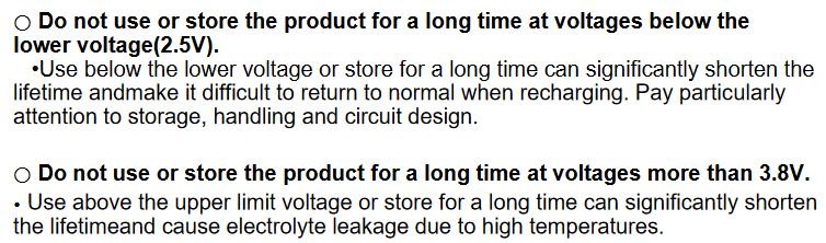

Unfortunately, there is one safety aspect which seems to have already been violated – namely that some of the lithium-ion supercapacitors have a voltage below the minimum voltage. After digging through several other manufacturer’s documentation, I have come to the consensus that this is not good for the capacitor and may even result in failure or be dangerous.
For example, this excerpt from VINATech’s User Manual for their LIC product makes it clear that it shouldn’t be stored for long below the minimum voltage or else, risking permanent damage.

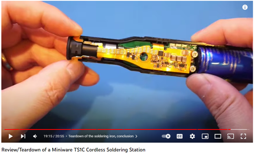

    scottiebabe over 2 years ago in reply to Gough Lui
    In random other news, a LIC supercap soldering iron lol
