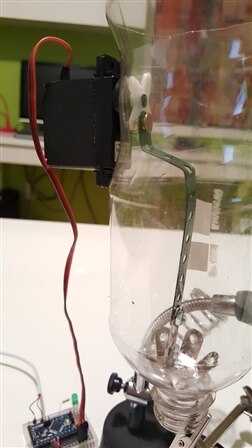

    I finally built my own kitty treat dispenser, thanks to your advice and design!
    I bought a knock-off Meccano type set for $3 at the dollar store and used pieces from that for the valve mechanism image
    For the photo, the whole thing is temporarily being held up by my "helping hands" (for soldering).
    I'll post more details on my blog next...
    ps, I couldn't find a big enough auger bit to build Michael's design... that's still on the list.
    edit: More details, and video, in my post: Cat Treat Dispenser

  • m.ratcliffe
    m.ratcliffe over 10 years ago in reply to ntewinkel
    I use the inspection tee because it has a flat base [Resists rotation when its clearing a blocked pellet], I have never had to open the tee, but it is nice to know it is there if the need ever arises. The one in this blog looks like it could work well too with a few small updates to the "paddle".
    The first model of the 3d printed version was printed today and the designs/file will be up after some real world testing.
  • ntewinkel
    ntewinkel over 10 years ago in reply to m.ratcliffe
    That auger design looks pretty nifty, Michael. And with a sharp enough drill bit it'll just slice through any kibble that threatens to get stuck image
    Do you find you need the "inspection" part of the Tee? I was wondering what that was for.
