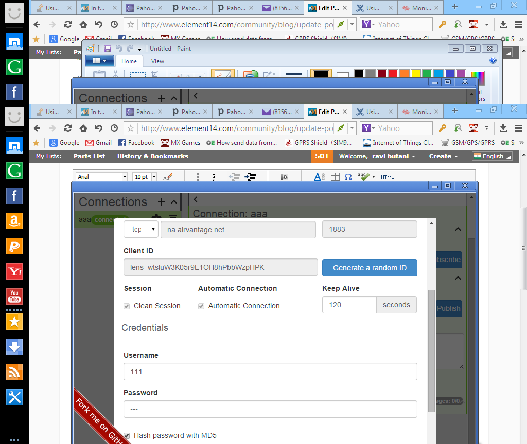

I have used MQTTLens Google Chrome extension as easy to use MQTT Client for Test my system on Airvantage cloud from https://chrome.google.com/webstore/detail/mqttlens/hemojaaeigabkbcookmlgmdigohjobjm
here is screenshot of connection setup to Airvantage system on MQTTLens... Here username is system serial no and Password is system password...

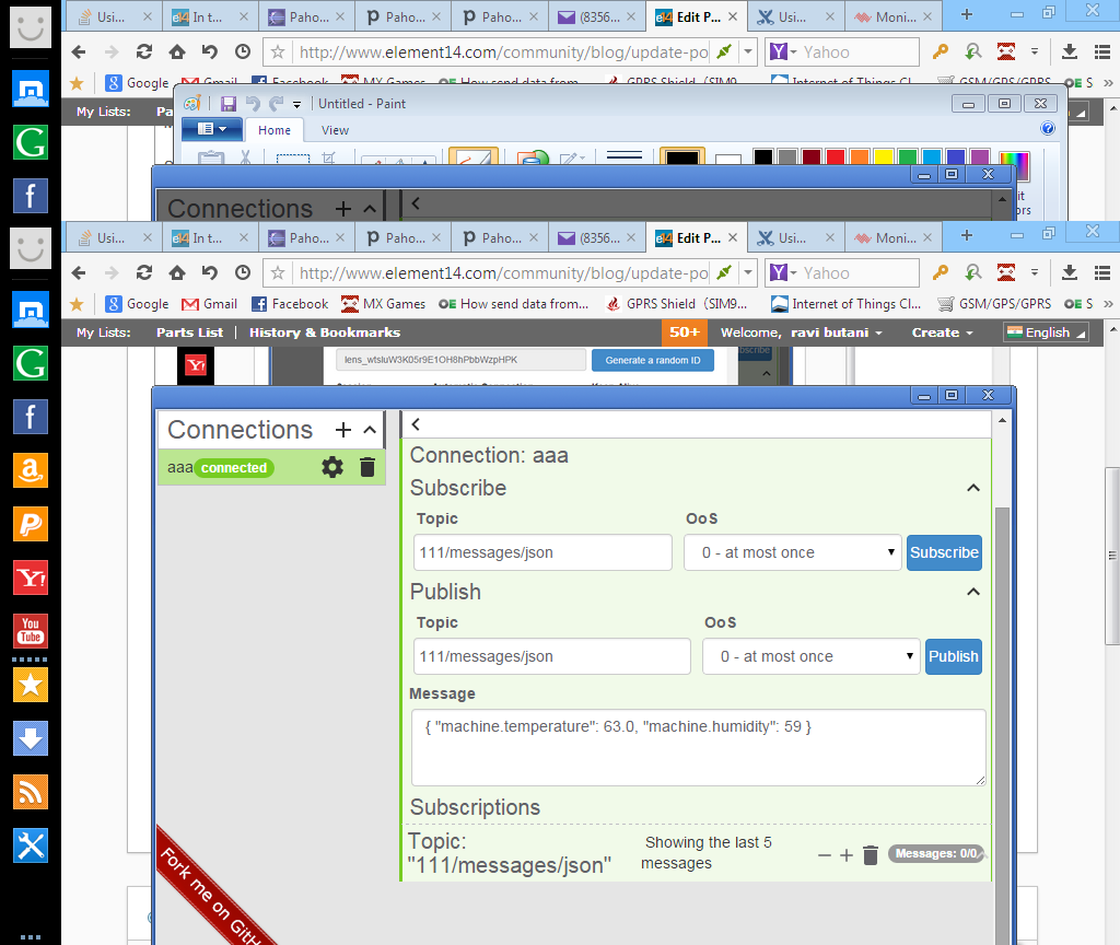

First subscribe to <username>/messages/json topic then send json string with data....

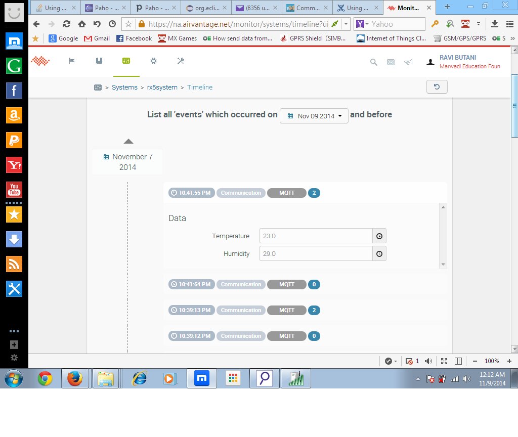

here is screen shot of my System working on Airvantage cloud..
once airvabtage start responding to your MQTT pulish message then move to next step...

U will see update on Airvantage cloud with your latest data....
