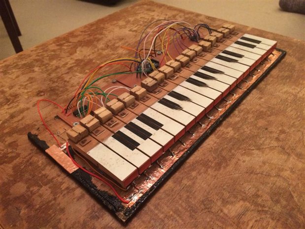

If you read my last blog post you would have seen that I started my project by prototyping ideas for the digitisation of the pianos key mechanism. Well, after spending the best part of a week attached to my soldering iron and multimeter I've finally completed most of the electronics and software for the final implementation of the key mech. The implementation for detecting key presses and releases has changed considerably since my initial design, and I've still got a bit of software tweaking to do, however I've now got a fairly reliable working key mechanism which is fully polyphonic, velocity-sensitive, and polyphonic pressure-sensitive.

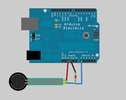

Due to using Velostat, the circuit used for each key of the piano is essentially the same as that for an FSR sensor connected to a microcontroller, where one side of the sensor is attached to power, and the other to a pull-down resistor to ground as well as to an analogue input:
An FSR sensor attached to an Arduino. Source: https://learn.adafruit.com/force-sensitive-resistor-fsr/using-an-fsr

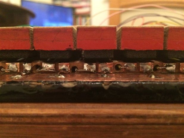

A small piece of Velostat has been attached to the underside of each key, and when a key is pressed it causes the Velostat to touch two contact points which closes a circuit (in the same way that a push button/switch works) and sends a pressure value to a dedicated analogue input for the pressed key. Since the prototyping stage I have rewired the keyboard so that the wires are soldered away from the area that the Velostat joins the circuit, allowing the contact area to be more even and allow greater touch sensitivity of the keys.
The Velostat attached to foam on the underside of each key, which connects two contact points going to power and ground/input when the key is pressed

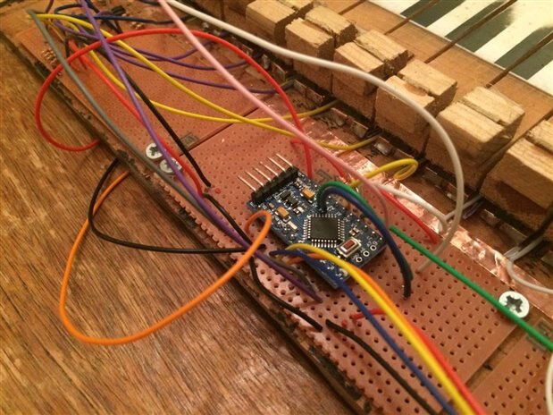

Microcontroller
Even though it will be the BeagleBone Black microcontroller that uses the values from the keyboard to trigger and modify sound, I decided not to connect the sensors directly to the BBB but to use a second mirocontroller in between that communicates with the BBB via one if its serial interfaces. I did this for the following reasons:
  1. Splitting tasks - The main job for the BBB in this project is to run a sound synthesis engine which is going to be time critical, so I don't want it to be doing any extra tasks that could slow it down. Also the scanning of the pianos 18 keys needs to be done as fast as possible so that the keys trigger sound as soon as they are pressed, so using a dedicated microcontroller for this task would be preferable.
  2. More Modular - Connecting a microcontroller to the BBB rather than connecting 18 sensors directly requires a lot less connections and wires to the BBB, which makes it easier to remove the key mech or BBB from the piano if desired.
I chose to use an Arduino Pro Mini microcontroller for the key scanner as it is a small, cheap microcontroller that I personally have had a lot of experience with. I'm using the 3.3V version (rather than the 5V version) as I believe that the serial ports on the BBB run at 3.3V which would not be able to communicate with a 5V microcontroller without using a logic level shifter. As the Pro Mini only has 8 analogue pins I've had to use two 4051 multiplexers to connect all 18 sensors to the Arduino; the first 8 keys are connected to 1 multiplexer, the last 8 keys are connected to a second multiplexer, with the middle 2 keys connected directly to the Arduino. This has meant I'm only using a total of 4 analogue inputs, as well as 6 digital outputs to control the multiplexers. Finally the serial transmit (TX) pin is used to send serial messages to the BBB.

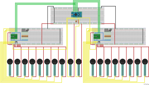

The Complete Circuit
The completed circuit for the key mech has been developed using stripboards which have been screwed to the base of the piano, as well a copper tape used as the power line to each key as well as for the contacts for the 'switch' below each key. Below is a breadboard diagram of the circuit I have built, followed by some photos of the circuit.
Breadboard diagram of the completed circuit, where the Velostat sensors have been replaced by FSRs
