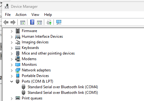

The above thing is mention in the document. I want to access the comp port of USB to JTAG/UART pod of ultra96 using serial terminal. I would like to know what is the process for it.
  • javagoza
    javagoza over 2 years ago

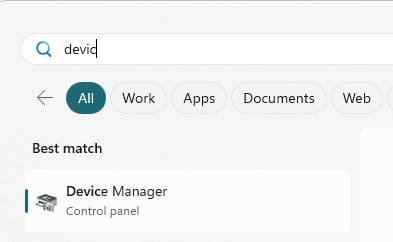

    From windows/Start find and open the Device Manager
    Then unplug and plug the device USB cable to see any changes under Ports to check if the COM port is assigned.
