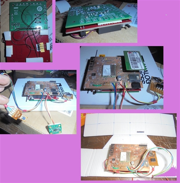

1.1. Chest Strap: It is designed around CC3200-MOD wi-fi supported module from Texas Instruments. The module have in built Body Temperature sensor (ADT7320), Heart Rate monitor with two electrode configuration (AD8232) , Chest impact sensor (ADXL375), 1Cell Lithium Battery and optional sub GHz transceiver to communicate with Helmet module.
more Build details with video are available here..
[real_time_monitor] Real Time Player Monitoring System Post#14 : Putting all together....
[real_time_monitor] Real Time Player Monitoring System Post#11 : PCB Designs

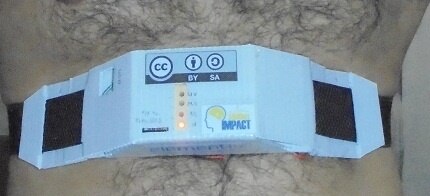

Here are some pics of Chest Strap design..
This module performs following functions
  • Monitor heart rate
  • Measure Body temperature
  • Measure Chest Impact Force
  • If SUB GHz transceiver is connected then also receives Helmet Impact data from Helmet module
  • Record all the raw sensor data to uSD card with 200Hz Sampling rate for Post processing purpose
  • Process sensor data and send it to Remote GUI Application via WiFi with UDP Protocol for Real time monitoring with 10Hz Sampling rate.

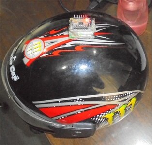

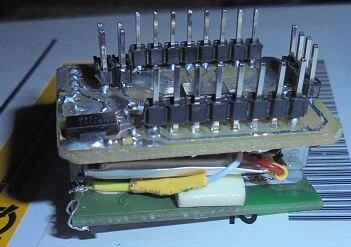

1.2. Helmet Module: It is Designed around MSP430 mcu, Helmet Impact sensor (ADXL377), on board Lithium battery and SubGHz transceiver.
  • Measures Helmet Impact.
  • Process this data and send it to Chest Strap via SubGHz transceiver.
  • As I have provided headers for available GPIO of MSP430, User can interface their custom designed sensors with this module.
  • More than one module like this can be placed on different body parts and they can communicate with chest strap simultaneously.
  • As SubGHz transceiver used here are addressable,Means they can be programmed such that there is no possibility of cross talk between Helmet module of Player-X to Chest Strap of Player-Y in multi-player application where players are in very close proximity.
  • It is also possible to have multiple modules like helmet module wearied on different body part with different sensors and all these module make communication to Chest Strap via small range SubGHz Transceivers and Chest Strap send this data to remote app via wifi communication.
