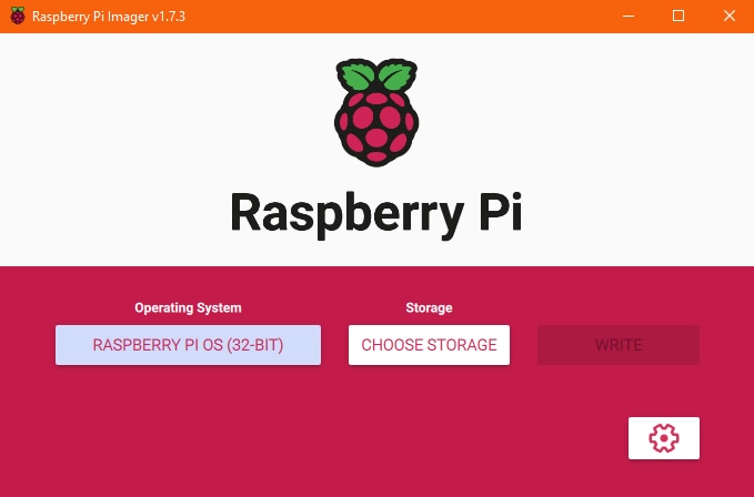

  • 6. Raspberry Pi Server
    • Setting up the Raspberry Pi OS

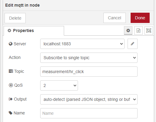

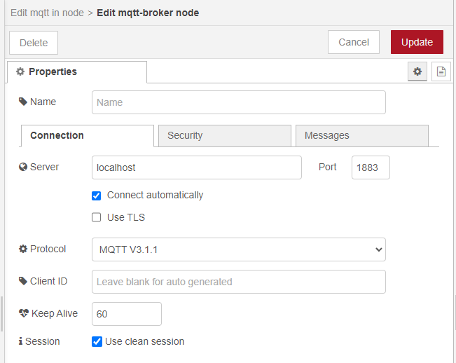

    • Node-RED
    • Mosquitto MQTT Broker

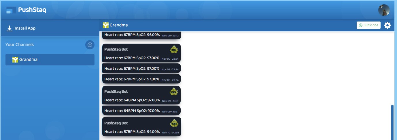

    • PushStaq
    • Simple PushStaq Test

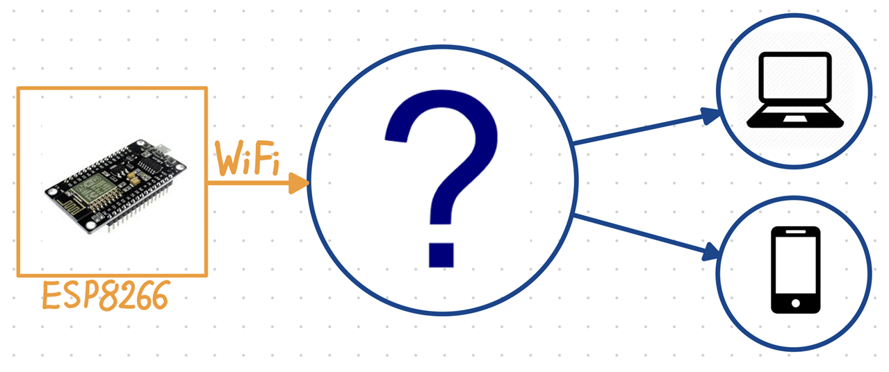

3. System Design
As mentioned in the section above, my whole second blog was dedicated to system design, but, at the end of that blog, I said I didn't have a solution yet in place for what I wanted to do for the server side of things. The idea is, I want the system to work in a way that when there is a new measurement, I get a push notification on my phone/computer.
Some of the things I considered were AWS IoT, Google Cloud, and Microsoft Azure, which are great options for systems that need to be scalable, but dougw gave me a great idea for this project, and that is to run a small server on a Raspberry Pi. This idea looked great to me since I already have a lot of experience working with the Raspberry and had a few of them laying around. I searched around a bit and decided to go with Node-Red, and with PushStaq for the notifications. I will get into individual things later in this blog. For now, here is how the whole setup is supposed to work.
There are 2 ESP8266 boards in the whole system, one is in the HMS device and the other one is in the clamp. Using MQTT, I want to upload the measurements to the Raspberry Pi server running Node-Red, which then pushes notifications to my phone or laptop using PushStaq. For PushStaq, no app notification is needed, it is browser-based, so all the user needs to do is click a link and subscribe. One thing I also plan to implement is monthly reports where I can send a mail with all of the collected data every month to myself. Every reading sent to the server will also be saved on the server, and I can then run Python scripts to do some data analysis and visualization.
Before we can test out the electronics shown in the previous section, we first need to sort out the server side of things. As mentioned above, my original idea was to use one of the services like AWS IoT, Google Cloud, or Microsoft Azure, but dougw gave me a great idea to use a Raspberry Pi as a server, and that's the approach I chose for this project since I have a few of them laying around. In this section of the blog, I will go all over the things that I needed to do to go from a message sent from the ESP8266 to me getting a notification on my phone with all of the relevant data. Let's take a look first at how the whole system is supposed to work.
Before I get into setting up everything, let's take a look at what's MQTT. MQTT is an OASIS standard messaging protocol for the Internet of Things (IoT). It is designed as an extremely lightweight publish/subscribe messaging transport that is ideal for connecting remote devices with a small code footprint and minimal network bandwidth. MQTT today is used in a wide variety of industries, such as automotive, manufacturing, telecommunications, oil and gas, etc. If you've worked with things like ROS before, the whole topic idea for messages will sound familiar. To put it simply, topics are channels to which we can either publish (post) messages or subscribe (read) the messages on that topic. For this, to work we need an MQTT broker. The MQTT broker is responsible for receiving all messages, filtering the messages, deciding who is interested in them, and then publishing the message to all subscribed clients. For all of this to work, here are the things I had to set up before I got a simple test to work.
The first thing we need to do is set up the Raspberry Pi operating system. For that, all we need is a microSD card and a microSD card reader for our computer. Raspberry released an amazing tool for installing operating systems for the Raspberry Pi called the Raspberry Pi Imager.
It's as easy as choosing the operating system and the storage to which we want to upload the operating system, with that being our microSD card. One reason I've shown this is because of the new feature they added to the imager that I haven't seen before, it's the little settings icon on the bottom right. There, you can automatically set things like languages, WiFi SSID and Password, and a few other things, which can speed up the process a bit later on.

After following that tutorial, all we need to do now is to use the Mosquitto MQTT Broker in Node-RED. Here is a way to do that. You first need to add an MQTT node and double-click on it, you will see the add new MQTT-broker option, click on it. Now you need to enter only the Server fields as localhost and 1883.
Once that is done, you can click Add and that's it. Now you can add the topic you want to subscribe to, and that's the topic that the Adafruit Feather Huzzah is posting to as we talked about in the Software section of this blog. It should look something like this.
As you can see in the picture above, the topic the ESP8266 will be posting to is measurement/hr_click. With that, the MQTT Broker is set up. There's one thing left to do before we can send notifications to our phones.

PushStaq is a real-time messaging platform to share text, links, and media between devices in a chat interface. One great thing about PushStaq is that it is web-browser based and it can push notifications like that to our phones, without us needing to install any additional apps. It can also push notifications to our laptops. To use PushStaq, all we need to do is set up a free account (or log in with our Google account) and create our channel. For someone to subscribe to the notifications, all they need is a link that we can generate in PushStaq that we can send to them. There they have to sign in and click subscribe to receive the notifications. Below you'll find a short tutorial on setting up PushStaq with Node-RED.
  • PushStaq tutorial: https://www.pushstaq.com/blog/node-red-push-notifications-with-pushstaq/
Here is a picture of how the app looks when it receives the data, as described above, it works like a simple messaging app.
