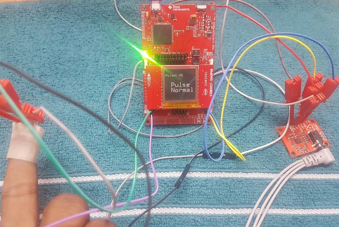

This weeks write up is ECG and Pulse.
For ECG signal conditioning I have used AD8232 Board.
And a Simple Pulse sensor from eBay.
The Setup & Pulse displayed in the Sharp LCD.

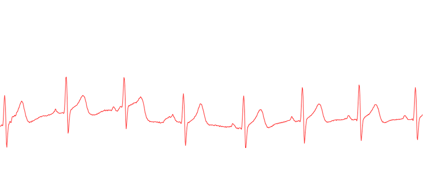

We also obtained the ECG waveform it isn't perfect probably due to bad ground.
I  was actually so dumb that I forgot to notice the Serial Plotter in Enegia IDE, had to copy data to Excel and Plot it .

    Hi Matt, well i don't have much background with medical equipment though I had Biomedical Instrumentation for a semester, I basically work with consumer electronics and Automation stuffs image
  • sakthi.1260
    sakthi.1260 over 9 years ago in reply to ipv1
    I never mentioned AD8232 is used on the finger image
  • ipv1
    ipv1 over 9 years ago
    That looks like an AD8232 board which is basically an ECG front end. Curious how you use it on the finger though.
  • jeepingoody
    jeepingoody over 9 years ago
    Like the idea and looking forward to following this project. I am curious as to your background with ECGs and vitals signs?
