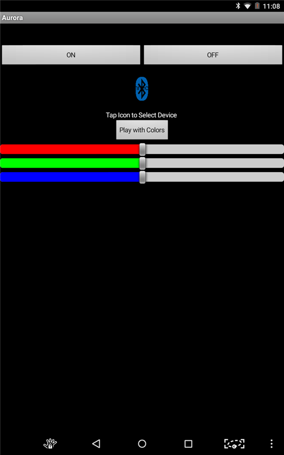

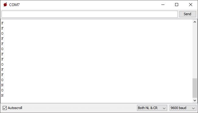

I had this android app written using MITapp Inventor long ago for some other purpose, but came handy for testing these modules. There are plenty of Apps like this in the store.
and Test results were both the modules worked.

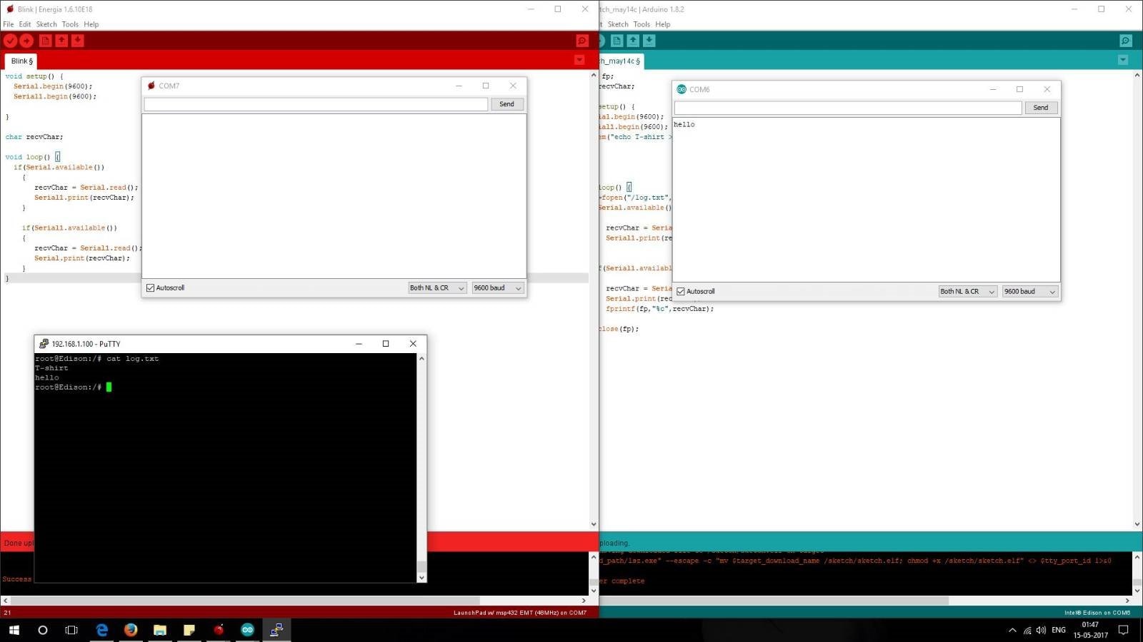

Sending data from Energia to Edison:
The Setup:
One hooked up with Launchpad another with Edison
HC-05                Launchpad            Edison in Arduino Breakout
  Tx                        P3.2                                     0
  Rx                        P3.3                                     1
  5V                         5V                                      5V
GND                     GND                                   GND
The code for Launchpad is same as the test code, for the Edison alone I've added a few lines, so that it can log the data into a text file. fopen() and fprintf() functions came in handy.

This data for now is the one I'm entering in the SerialMonitor of Energia IDE but this actually will be the data collected from the Sensors in the upcoming blog.
Sent a "Hello" from LaunchPad to Edison
Voila!
