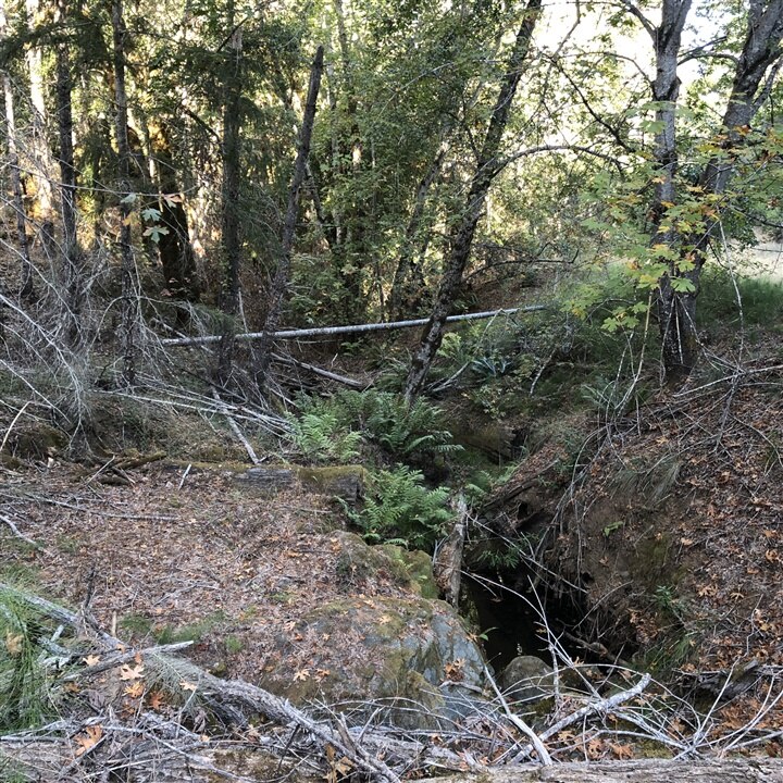

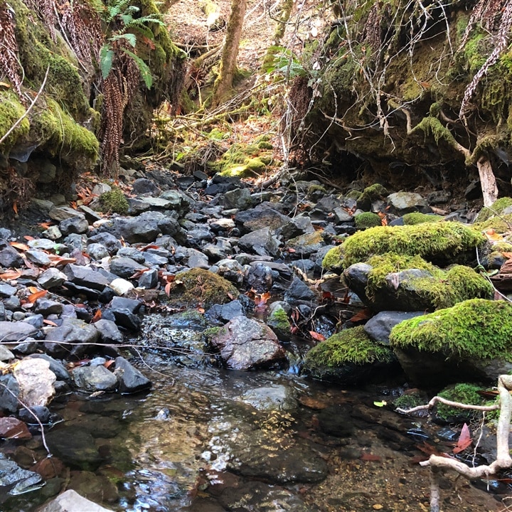

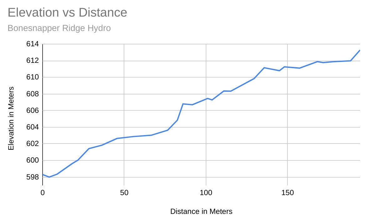

The stream runs through a large part of the property dropping in elevation. I walked the creek from the bottom to the top looking for good sites to collect water, and to place the turbine. The graph below shows the elevation & distance between these locations. Yes, it's in reverse, but I walked from bottom to top and did battle with google sheets and lost... Currently, it is October and the dryest part of the year in my area. There is still flow in the stream right now. Not much, but it is running. From observing (what I think are) the high water lines, it will have quite a bit of water flowing during the winter months.
As you can see, we get about 16m of elevation drop over about 200 meters in distance. I think this qualifies as a "low head" system. I won't know a GPM or L/S rate until it the rain starts, and I get a capture system in place.
I will also need to run a conduit from the hydro generation site up to the solar site since that is where all of the batteries will be.
