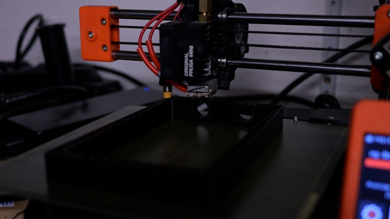

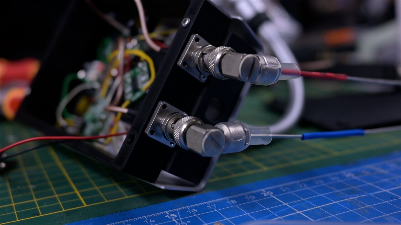

For the antenna, Clem went with the tried-and-true method of using 1.6mm thick tinned copper wire, which he straightened by twisting it in a drill. Classic! To keep things neat, he 3D-printed custom inserts for BNC connectors, ensuring that the antennas were well-isolated from the housing walls. While PLA didn’t quite cut it for this application, MAYER MAKES Engineering Resin was the perfect fit. It had the right tolerances and strength to replace the old nylon inserts, which couldn’t accommodate the new, thicker antenna wires.

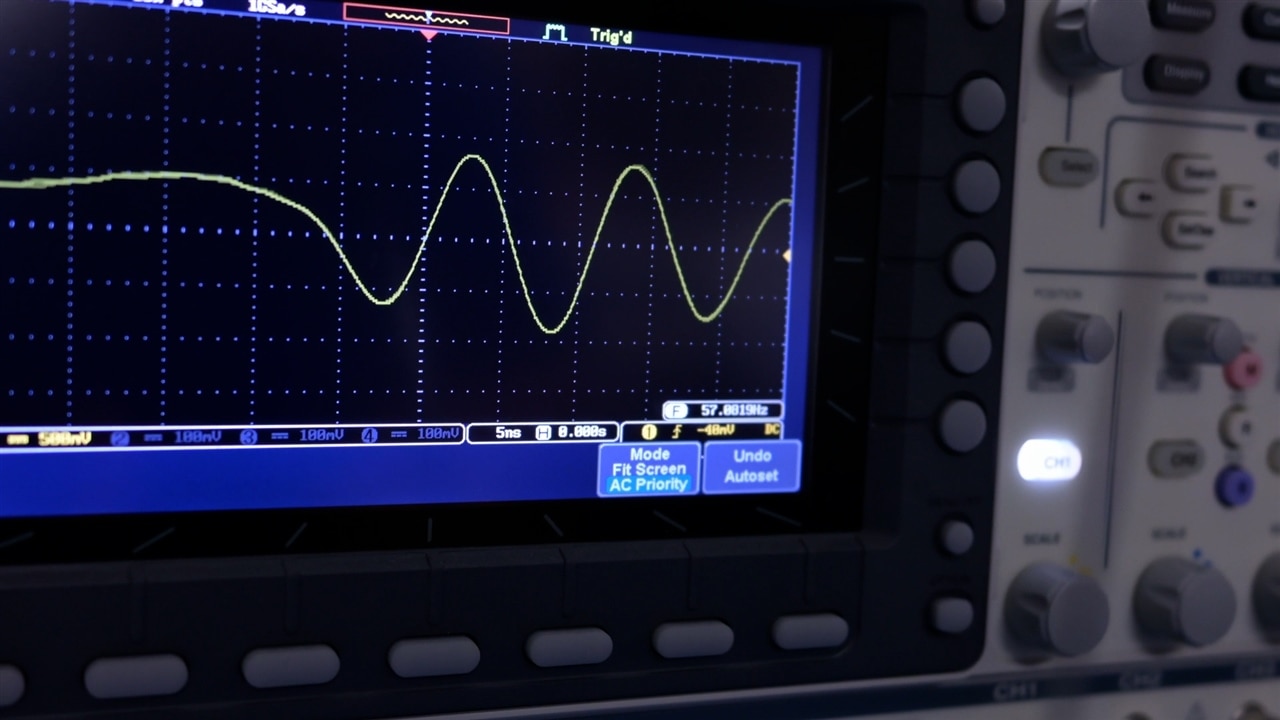

The first test was promising but not perfect. When Clem pressed the button, the unit did send a signal—but it wasn’t quite the sine wave he expected. Instead, it looked more like a digital signal. Curious but not discouraged, he built a second unit, hoping to establish a clear link between the two. And yes, there was a connection! However, instead of the sound he hoped for, the speakers emitted only a faint crackling noise.

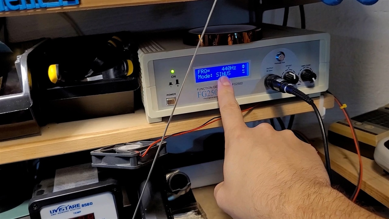

Armed with a signal generator, Clem injected a known frequency into the transmitter to see how the receiver would react. The result? Success! The devices did indeed communicate with one another, and the signals changed based on the input. The catch? The signals weren’t audio; they were digital pulses—essentially the duty cycle of the input signal being transmitted and received.
That’s when Clem had a light-bulb moment: these RF modules communicate only in digital signals, meaning they transmit data as discrete on/off pulses. To get audio working, Clem would need to encode, transmit, and then decode the audio into a digital format. He sketched out a schematic that combined a known PWM (Pulse Width Modulation) carrier signal with an amplified microphone input. This method would transform the sound into a digital signal that could then be sent over the RF modules.

    To your antenna question:  You have a monopole.  Your chassis is the ground plane (other side of the antenna).  In amateur radio, the most typical monopole is the 1/4 wavelength ground plane.
