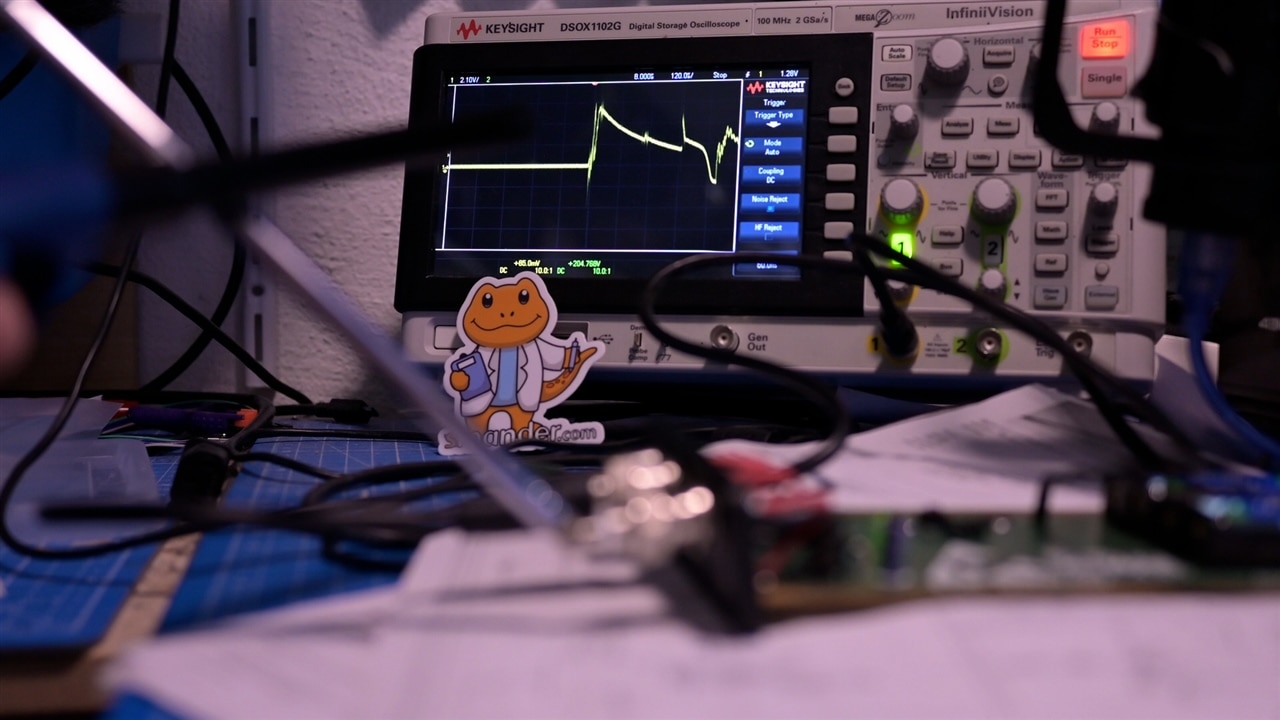

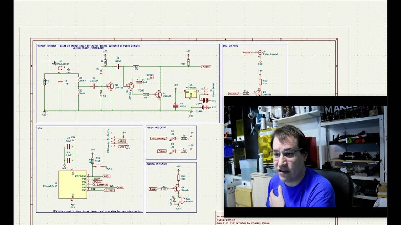

Clem builds a custom ESD detector to identify electrostatic discharge events that can interfere with electronic circuits and cause unexpected glitches. Based on a proven design by Charles Wenzel, the detector outputs a logic-safe pulse that can trigger test equipment like oscilloscopes, helping correlate ESD with system faults. The video covers circuit design, case integration using EMI-shielded enclosures, and real-world testing scenarios. Download the design files and see how you can build your own low-cost debugging tool.

The ESD detector Clem built is designed to monitor for electrostatic discharge events and output a signal when one occurs. This signal can trigger test equipment like oscilloscopes, allowing users to observe the exact behaviour of a system during an ESD event. This functionality is especially useful for identifying issues in systems where timing and signal behaviour are critical.
The Circuit Design
Clem based his ESD detector on a design by Charles Wenzel of Techlib.com. Wenzel’s circuit is known for its sensitivity and reliability, which makes it a strong foundation for detecting subtle ESD events. Clem obtained permission from Wenzel to adapt and use the design, emphasising the importance of adhering to licensing terms and respecting intellectual property. This step ensures ethical practices and fosters collaboration within the electronics community.

In his video, Clem tests the ESD detector in several scenarios, demonstrating its utility in real-world applications. Examples include:
Detecting static discharges from common sources.
Monitoring motor firings to identify noise-induced disruptions.
Capturing the precise timing of glitches that align with ESD events.

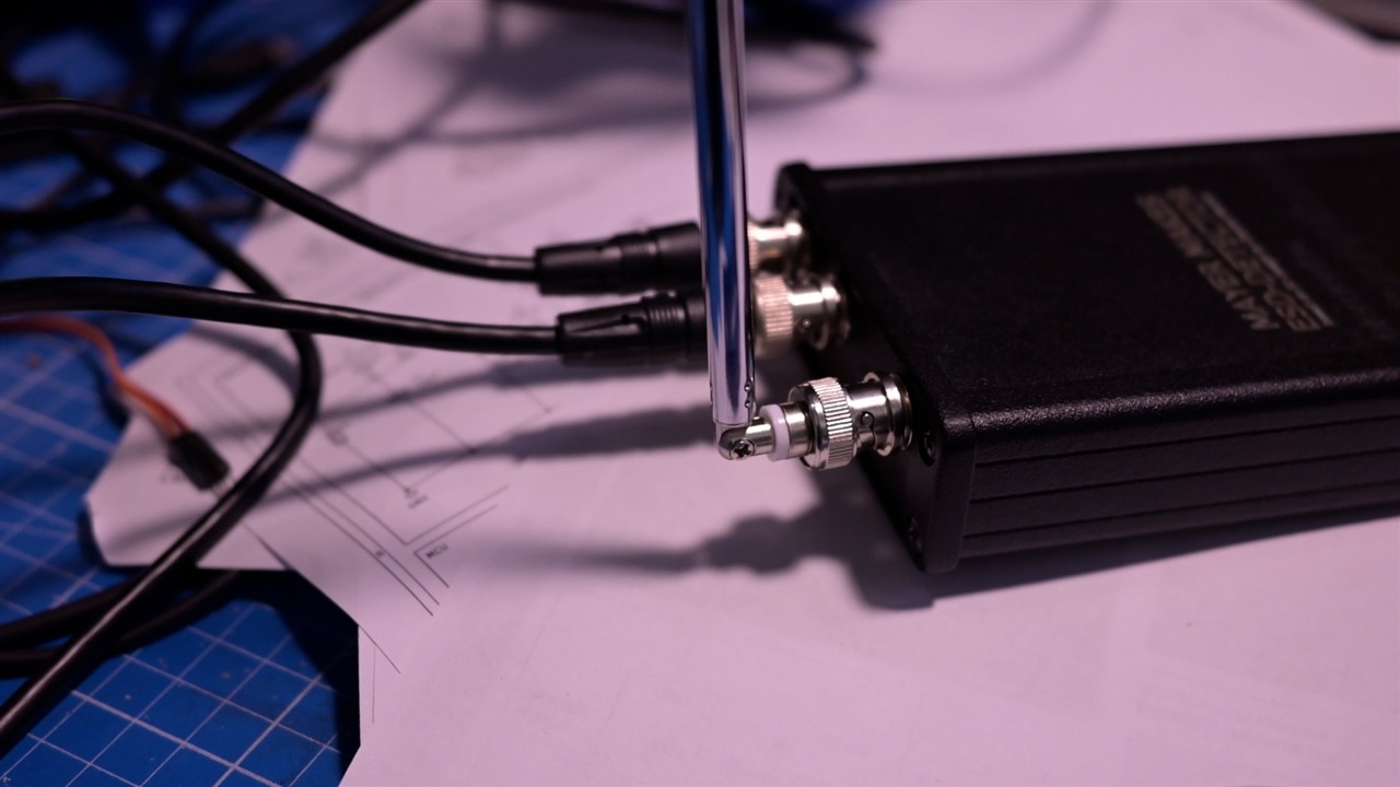

BNC connectors Panel mount
Power switch
BNC antenna

    Hello Clem, You might want to consider changing your video a bit because you don't describe the circuit correctly and this may be very confusing. The input network of R1, C1 , L1 and L2 is a 300kHz…

    Thanks for pointing that out. While I can't change the video after the fact, we can at least have these things documented here for future readers and maybe pin the comment. I looked through my notes to see why  I mixed that up.
    Since the video was done a few months ago, I can´t remember really but I assume that I thought about a different simpler design that I also tried in preperation of the video while recording.  Iscraped the simpler design as it did not reliably trigger on smaller sparks, but kept it in memory while recording.
    Analog circuits are not my usualy game so I might just have defaulted to darlington pair once I spotted two transistors close to each other.
    Sorry for the error and thank you for pointing it out!

    Hello Clem,
    The input network of R1, C1 , L1 and L2 is a 300kHz band pass filter and impedance matching network.
    Q2 and Q1 are not a Darlington pair but a rather neat mono-stable.
    These things are correctly described by Wenzel at https://techlib.com/electronics/lightning.html
    How about hanging a scope on your design to show the Q1, Q2 part of it in operation ?
    MK
