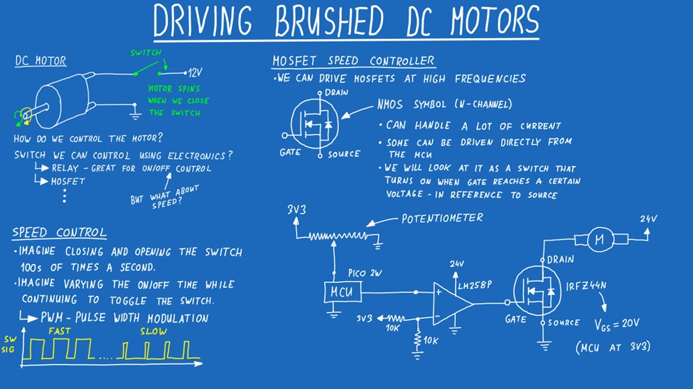

How Do Motor Drivers Work?
Milos begins by stripping motor control down to its simplest form. A brushed DC motor will spin if you connect it directly to a power source – effectively simulating a battery. That approach works, but only in the most basic sense. There’s no speed control, no direction control, and no feedback. The next step is switching the motor on and off rapidly. By toggling a switch hundreds or thousands of times per second and varying how long it stays on versus off, you create Pulse Width Modulation (PWM). A wider pulse delivers more energy to the motor; a narrower pulse reduces it.
To do this electronically, Milos demonstrates a simple N‑channel MOSFET circuit. A MOSFET behaves like a fast electronic switch and is far better suited to high‑frequency PWM than a relay. In his bench example, he uses an op‑amp as a level translator so that a 3.3 V microcontroller can properly drive a MOSFET that expects a much higher gate voltage. This approach works well for speed control, but it has a fundamental limitation: the motor only spins in one direction. As Milos points out:
“There really is no way to switch the direction of the motor driving besides flipping the wires around.”
Direction control requires a different topology altogether.
H‑Bridges and Direction Control
To reverse a motor electronically, you need to flip the polarity of the voltage applied to it. This is achieved using an H‑bridge, which arranges four transistors so current can flow through the motor in either direction.
Milos explains the logic clearly, including the importance of never enabling both transistors on the same side of the bridge at once, which would effectively short the supply. With an H‑bridge and PWM applied to the appropriate control line, you gain full control over both speed and direction. At this point, he references a familiar module:

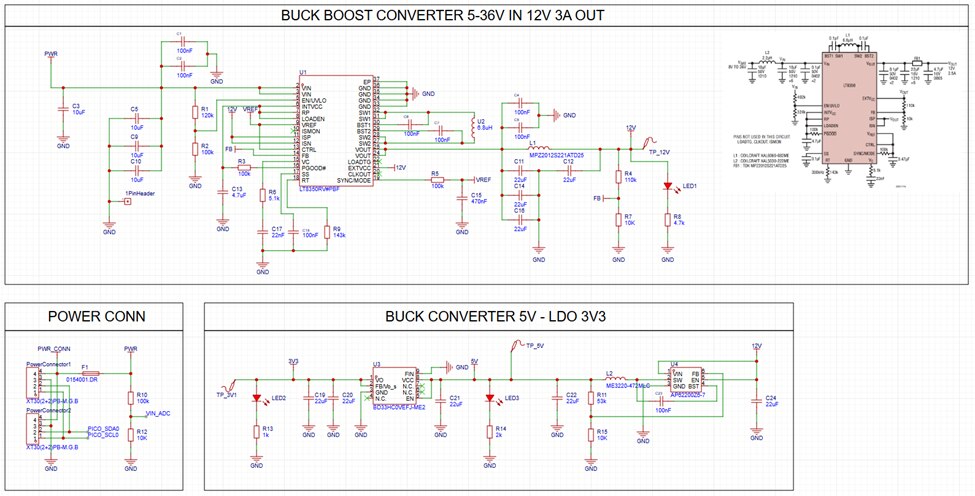

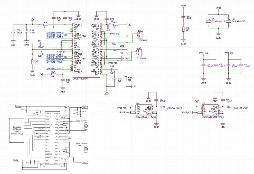

Electronics and Power Architecture
With the requirements defined, Milos starts with the most critical component: the motor driver IC. After filtering options and reviewing datasheets, he selects a Texas Instruments dual H‑bridge driver capable of handling the required current in a compact package. That choice introduces an immediate design challenge: the driver requires a stable 12 V supply, regardless of the board’s input voltage. To solve this, Milos implements a buck‑boost converter, allowing the board to operate from roughly 4 V up to 40 V while still generating a clean 12 V rail.
From there, power is stepped down in stages:
  1. Buck‑boost → 12 V
  2. Buck → ~5 V
  3. LDO → 3.3 V
This staged approach reduces noise on the 3.3 V rail, which is critical for ADC measurements, current sensing, and encoder feedback.
“The LDO is like a smart resistor… you get a clean nice output of 3.3 V in the end.”
For current sensing, Milos chooses Hall‑effect current sensors rather than shunt resistors, valuing their stability and isolation.
The board also includes:
  • Input voltage measurement via a divider
  • A fuse for protection
  • XT‑style power connectors with additional communication pins
  • Switchable I²C pull‑ups
  • An RGB status LED controlled over I²C

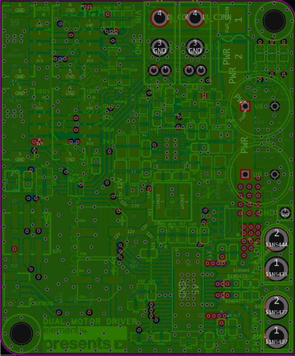

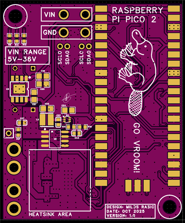

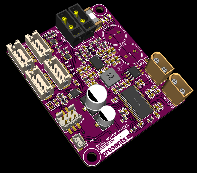

PCB Layout and Physical Design
Once the schematics are complete, Milos moves on to PCB layout. The final board measures 50 mm × 60 mm and uses a 4‑layer stack‑up (SIG–GND–GND–SIG). Much of the board size is dictated by the Raspberry Pi Pico 2 module, which Milos mounts directly rather than designing a custom RP2040 layout for this revision.
The PCB is dense but carefully partitioned:
  • Power conversion sits centrally
  • High‑current motor paths are kept short and wide
  • Sensitive analog and MCU sections are isolated
  • Large copper pours and a defined heatsink area help with thermal management
The result is a compact yet expandable board, complete with Milos’ Platypus mascot and a clear “GO VROOM!” silkscreen reminder of its purpose.

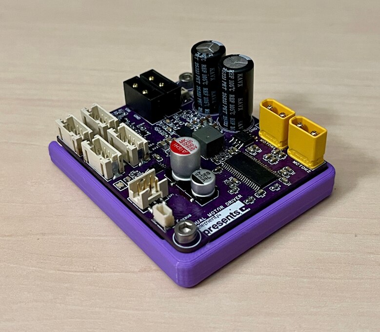

Assembly, Checklists, and Debugging
Rather than soldering everything at once, Milos relies on a soldering and testing checklist, assembling and validating the board in stages:
  1. Buck‑boost converter
  2. Buck converter
  3. LDO
  4. Motor driver
  5. MCU and peripherals
This method quickly pays off. While the board works almost entirely as intended, two errors are discovered:
  • An incorrect footprint for one IC, requiring hand‑extended pins
  • A buck converter enable pin that could not tolerate 12 V, repeatedly destroying the IC
“Because of the checklist, I managed to identify what was wrong and why… otherwise I would’ve probably burned a lot more chips.”
Milos documents these issues in an errata sheet, reinforcing the idea that revision‑friendly design is part of good engineering.

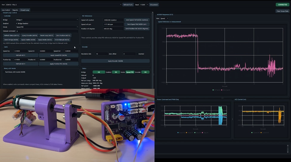

On the software side, the board runs firmware that deliberately avoids high‑level robotics logic. Instead, it exposes a command‑driven motor control interface over USB, UART, and I²C.
The firmware is structured around several key components:
  • DualMotorController
    Handles PWM generation, fault detection, current measurement, and direction control.
  • ClosedLoopController
    Implements manual control, speed PID, and position PID modes.
  • As5600Encoder
    Interfaces with the AS5600 magnetic encoder, handling wrap‑around, filtering, and unit conversions.
  • CommandProcessor
    Parses human‑readable ASCII commands (M‑codes) and compact binary frames.
Notably, PWM is capped at 95% duty cycle (PWM_ACTIVE_MAX = 950) to ensure bootstrap capacitors in the motor driver remain charged – a subtle but important hardware‑aware firmware detail. Speed and position control are implemented using the PidController class, with tunable gains, integral limits, and output clamping.
In practice:
  • Speed control works best as a PI controller, since derivative action introduces too much noise at the encoder sampling rate.
  • Position control benefits from P and I terms, with careful tuning to avoid integral wind‑up.
“If you try doing anything with the derivative part, you just get a bunch of noise… so we’ll essentially just use a PI controller instead.”
The firmware also includes:
  • Automatic direction self‑checks
  • Encoder zeroing
  • Gain scheduling hooks for future improvements
To make tuning and testing practical, Milos builds a custom Python GUI using PySide6. The GUI provides:
  • Real‑time plots of speed, position, current, and PWM duty
  • Live status indicators for faults and thermal warnings
  • Manual control sliders
  • PID tuning panels
  • Encoder configuration and zeroing
  • Binary and ASCII telemetry support
This interface turns the board from “just hardware” into a usable development tool and makes PID behavior visually intuitive.
Finished Project and What’s Next
In the end, Milos considers the project a success:
“I’m really happy with how this PCB turned out… it’s bigger than the module we started with, but it’s a lot more capable.”
The board meets nearly all of its original requirements, and the few shortcomings are clearly documented. Future plans include:

    michaelkellett 4 days ago
    Nice project - thanks.
    Your schematics are not expanding enough to be legible.
    I can read very little of the Buck/Boost diagram and only some of the others.
    It would be good if you could re-post them so that they expand to something bigger and clearer.
    MK
  • michaelkellett
    MK
  • milosrasic98
    milosrasic98 14 hours ago in reply to michaelkellett
    Thanks, glad you like the project!
    Sorry for that, I've just uploaded the PDF version to GitHub, let me know if that works, here is the link: https://github.com/MilosRasic98/OpenDualMotorDriver/blob/main/Hardware/Schematics/SCH_Schematic1_2026-05-09.pdf
