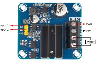

    robogary 6 days ago in reply to milosrasic98
    Bullet connectors may be a good fit, do they require pigtails from your board, or are there PCB jacks available ?
    As beacon_dave  points out, ESCs use bullet style connectors on their output for brushless motors, and XT30/60 (or Ts) for the power input.  It'd be kind of funny to watch someone's face to try to plug in a 3 wire brushless motor into a 2 wire H bridge output.
    Anyway, the connector discussion has taken on a life of its own, whatever you choose is OK, I just thought I'd mention about the motor connectors looking like battery connectors, and 5A projects may likely use Lipo batteries.
    For larger projects that L298N comes up short,  I use IBT-4 , 50A H bridges. They use screw connectors for both motor and power.
    When I put these in a project, its usually running with one or two 12V 7000mAh lead acid batteries.   These connectors have been reliable, but I've had to make sure to use crimp ferrules on the 10 AWG wires to ensure no whiskers touch. I use in line automotive fuses with these bridges.
