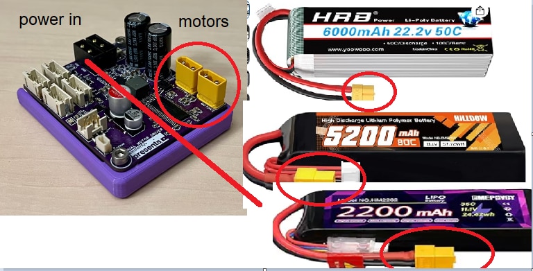

  • beacon_dave
    beacon_dave 8 days ago in reply to robogary
    Looks like XT30 batteries can be plugged in directly as it stands. It looks like Milos is using an XT30 connector to the bench PSU.
    Swapping the gender of the motor connector might help if RC battery packs are standardised.
  • robogary
    robogary 8 days ago in reply to beacon_dave
    Yes sir - My reply suggestion is to change the power connectors on the board.
    Sizable drones, vehicles, and hobby robots use Lipo batteries with XT60 or XT30 connectors. see attached screen shots
    The batteries could be directly plugged into the board.
    Change the motor connectors to another form factor so people dont plug LipO batteries into the motor connector,
    PCB to screws for example, motor leads can use ring terminalsimage
    separate i2C wiring away from power leads
    example Lipo XT60 connectors

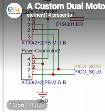

    beacon_dave 9 days ago in reply to robogary
    Motors are on XT30
    and Power is on XT30(2+2) with the additional I²C data channel.

    The Vin and GND connectors, I didn't recognize the connector type, altho there is a PN MP011760 for it.
    In my humble opinion, I'd use the XT60s or T type connector for power input so a battery can be plugged in directly.
    The motor can have a different style connector or screw terminals.
