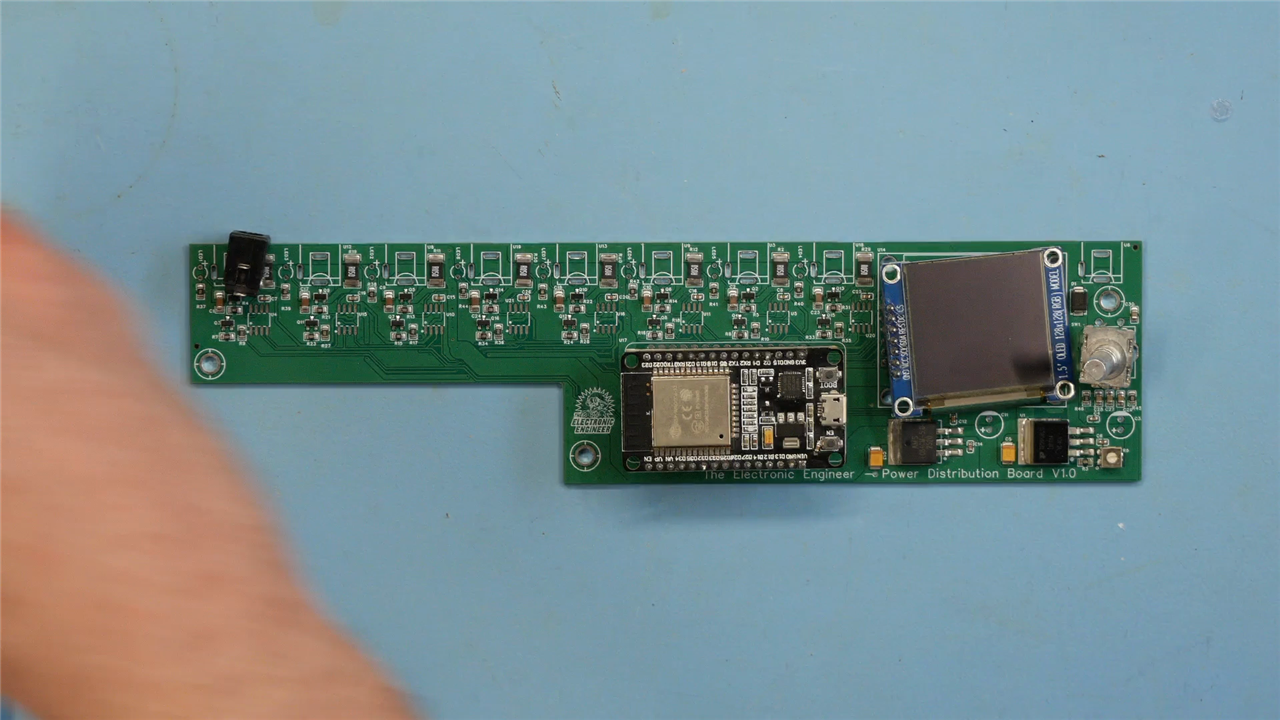

System Architecture and Hardware Design
At the core of the system is an ESP32 microcontroller, chosen for its versatility and ability to manage multiple inputs, outputs, and communication tasks simultaneously. The hardware is divided into several key functional blocks:
  • Eight independent output channels
  • Dedicated current sensing per channel
  • Switchable outputs via MOSFET stages
  • Dual power regulation (fixed 5V and adjustable rail)
  • User interface via rotary encoder and OLED display
Each output channel is effectively identical, simplifying both PCB design and firmware logic.
“It’s eight of them and they’re all the same… we have our energy monitor… outputs that can be enabled or disabled.”
The bill of materials listed out at the end of this blog reflects careful component selection, including:
  • INA219 current sensors for precise per-channel monitoring
  • Onsemi MOSFETs (FDN340P / FDN335N) for efficient switching
  • LM1084 adjustable regulator for configurable output voltage
  • Precision resistors and capacitors supporting stable measurements
This combination ensures accuracy in measurement while maintaining robustness under varying load conditions.

Although many surface-mount components were pre-installed, assembly still required careful handling, particularly for fine-pitch soldering.
“That’s why I use a microscope… I instantly see it and I can correct it.”

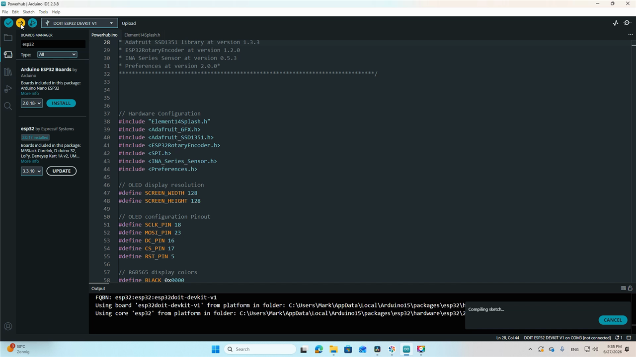

Firmware: Monitoring, Protection and Control
The firmware ties the entire system together, managing inputs, measurements, and output control in real time. The structure follows a typical embedded pattern:
  • Initialisation in setup()
  • Event-driven loop for interaction
  • Periodic safety checks for protection
A key feature is continuous monitoring of current across all channels, with automatic shutoff when limits are exceeded.
“Whenever that current is exceeded… the output will be disabled immediately.”
A simplified representation of this logic appears in the code:
// Periodic overcurrent check (conceptual)
if (measuredCurrent[channel] > maxCurrent[channel]) {
    disableOutput(channel);
    setChannelState(channel, TRIPPED);
The firmware also maintains persistent state using non-volatile memory, ensuring that configuration and energy data survive power cycles.
“We retrieve some parameters from the non-volatile memory… channels that were on or off last time.”

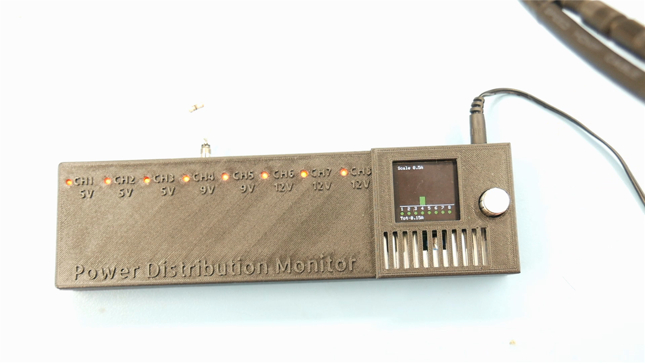

Enclosure Design, Future Improvements and Expansion Possibilities
A custom 3D-printed enclosure brings the project together, ensuring:
  • Secure PCB mounting
  • Correct LED alignment
  • Accessible controls
  • Thermal clearance
The integration of mechanical, thermal, and electrical elements demonstrates a complete product-oriented approach rather than a simple prototype. While already feature-rich, the design naturally opens the door to further enhancements:

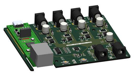

    It happens that I'm in the process of building a 12V distribution board quite similar to yours.
    Mine is aimed more for routers / modems / switches / SBC-s, has 4 output channels, and is based on the W55RP20-EVB-Pico (for LAN connectivity).
    It also has current sensing (slightly different architecture than yours) and dual power input for redundancy.
    Currently, I'm waiting for the PCB and components to arrive. Once the board is assembled and tested, I will post a detailed project description here at E14.
