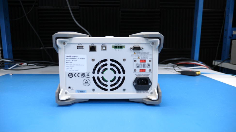

On the back are ports for remote interfacing through RS-232, LAN, and a USB device. A digital I/O port lets you enable channels with external signals or provides output signals based on conditions you set through the user interface. The USB host port accepts drives to save data from the recorder or data logging features.

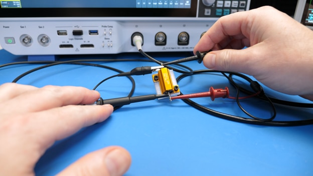

The ripple voltage measurement used a 10 ohm (25-watt) power resistor and oscilloscope. A resistor provides more stability than an electronic load since the load will adjust its reactance based on the output voltage. Sometimes, an electronic load can cause more ripple than the supply actually has. The MP711001's ripple, or regulation, is specified up to 1 MHz with less than 2 millivolt peak-to-peak (mVpp). Using a 1 MHz (digital) filter on the oscilloscope, James demonstrated that the supply ripple was only about 1 mVpp when outputting 25 watts. Even though he did not use a power rail probe, he felt the measurement agreed with the datasheet.

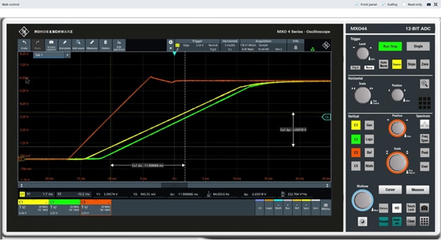

FPGA development boards often have several voltage rails and a specific order in which they need to turn on. So, for the next test, James checked to see how much skew each channel had when activated simultaneously. It turns out Channel 3 activates first, followed by 1 and then 2. The channels exhibit some jitter with each turn-on. However, the order always seems to be the same. The skew between channels 3 and 1 is about 10 milliseconds, while the skew between 1 and 2 is less than 2 milliseconds. These values are consistent enough that they should be suitable for sequenced turn-on requirements.

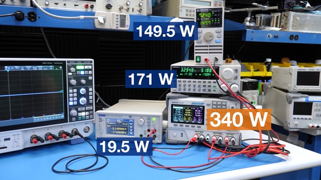

The last test is what James called his "most ridiculous test ever." Using three electronic loads, including the AIM TTi SMU4002, he loaded the MP711001 bench supply with 340 watts. The result was impressive. The peak-to-peak voltage on one of the channels was similar to the 25-watt loading. James has no reason to suspect that the supply couldn't make it all the way to 348 watts. As a side note, a Kill-A-Watt meter measuring the 120 Vac mains side of the supply showed the bench supply drew about 5.3 amps during this test!
