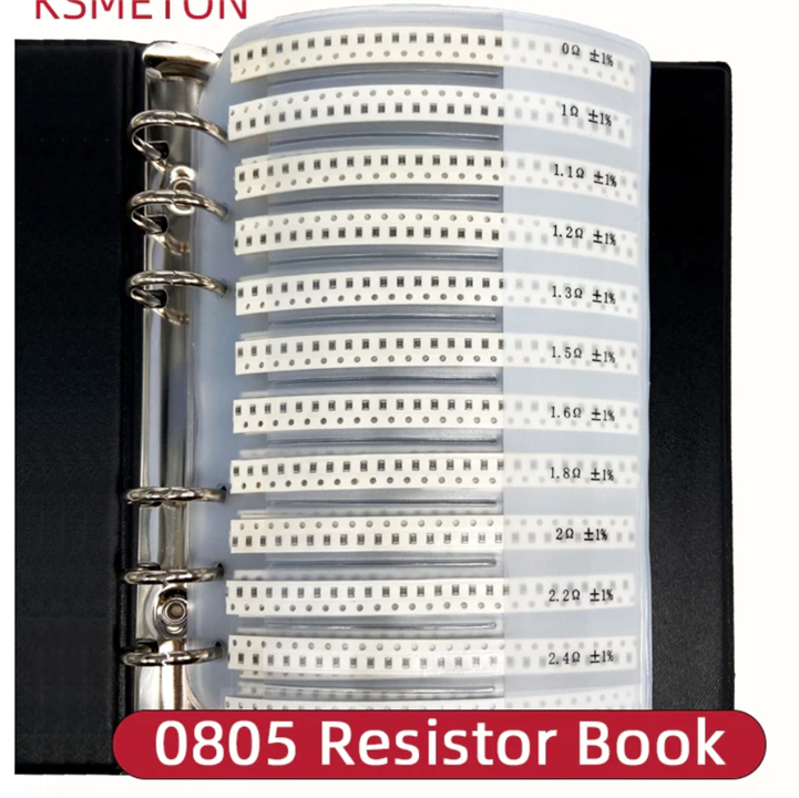

Component stock - standardized
As alluded to above, it pays to keep a standard set of components in stock because it speeds up both design and build. I stock and use 0805 components wherever possible to keep stock at a reasonable cost and efficiently managed.
Resistors
For surface mount technology I have standardized on the E12 series of values to minimize the number of resistors that I need to stock. The E12 series has 12 values per decade where values are approximately evenly spaced on a logarithmic scale. I have 6 decades from 1 ohm to 10 MOhm which ends up to be 72 values. These are stored in a matrix of slots with the decade on one axis and the log value on the other axis.

    fmilburn over 4 years ago
    That is a really complete list with lots of ideas.  Standardizing on parts is something I've done as well and I bought a book with 0805 SMD resistors and capacitors similar to this one.
    Resistor Book
    They are expensive from major manufacturers but not so much when ordered from low-cost Chinese sources.
