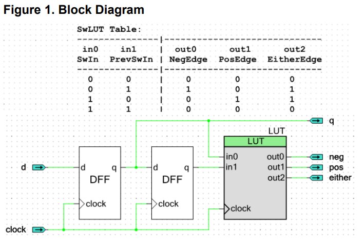

    I agree. I just wanted to point out that the Debouncer datasheet shows the circuit diagram and it can even be built by the internal components manually (Or even external discreet components, but this would…

    I just wanted to point out that the Debouncer datasheet shows the circuit diagram and it can even be built by the internal components manually image (Or even external discreet components, but this would be very ineffective.)
    I am glad that Cypress is trying to solve the most common issues that engineers have. (How many applications you have done incorporate at least one button?) I think it would be great to see more circuits like this in microcontrollers of other manufacturers.

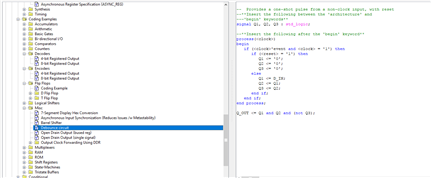

    I've checked out fpga debouncing a while (oh - 2014, I'm getting old) ago.
    Here's the 1st video (out of a series of 3) about that:
    Videos 2 and 3 here and here.
    My code was based on an example template that comes with Xilinx ISE:
