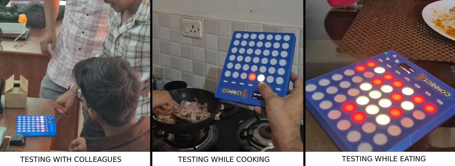

I tested the usability of the device with my colleagues, girlfriend and couple of friends.
Reviews
  1. Definitely portable and fun to use. They Loved the tactile.
  2. Size could have been slightly smaller
  3. Feels solid in hand. (They were referring to the build quality)  I added ribs inside the casing to make it more rigid. This was done before the deadline i missed documenting above.
  4. The Drop effect was realistic.
