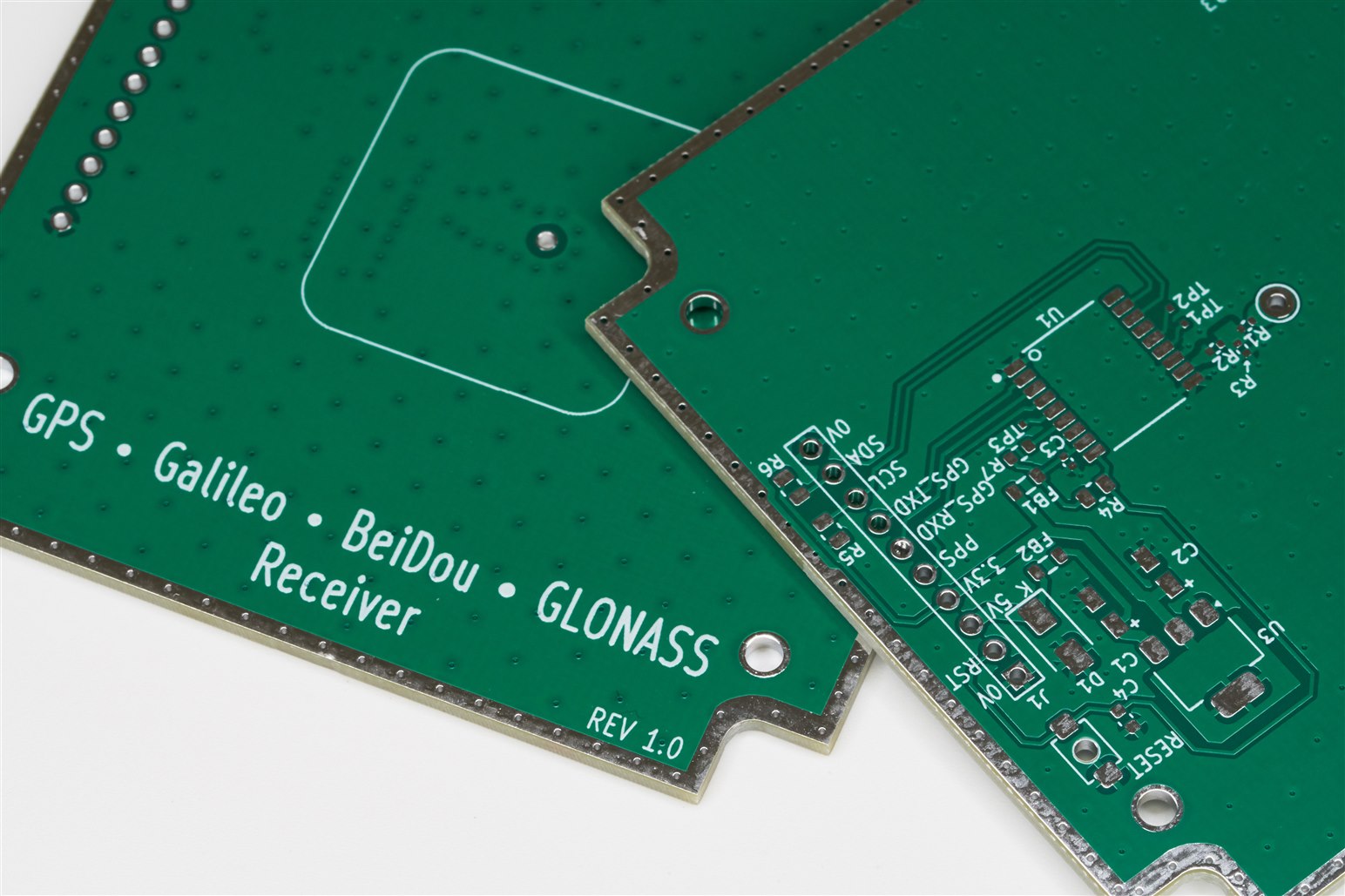

Anyway, long story short, since the prototype worked, I went ahead and produced a KiCad PCB design, which broadly follows the prototype layout. The boards should arrive in a couple of weeks.

  • The PCBs arrived yesterday, and I've tested by assembling a couple of them. I believe (with my limited understanding) that they work well: about a dozen satellites are detected indoors a few meters away from a bay window, and the GPS 'Dilution of Precision' values HDOP and PDOP are both "Excellent" (values between 1.0 and 2.0). I've not tested outdoors or close to the window yet. It would be interesting to know how it performs in other locations/countries too!
    The testing was easy; wire the GND and 5V supply pins, and the RXD and TXD pins, to a 3.3V logic-level USB-UART module, and then plug into a Windows PC and run ST's Teseo-Suite app ( https://www.st.com/en/embedded-software/teseo-suite.html ) . It auto-detects the USB-serial device and immediately starts showing the information graphically.
    I have a few spare blank PCBs, if anyone in the UK wants one, please let me know and I'll post it, plus all the resistors/capacitors, for free. Three of the parts are 0402-sized so that needs a fine iron or other technique. If you're not in the UK, sadly due to crazy shipping costs, the blank PCB is not worth sending, because it would be much cheaper to get it directly from any China PCB manufacturer using the Gerber files on the Github site ( https://github.com/shabaz123/teseo_iii_gnss ).
