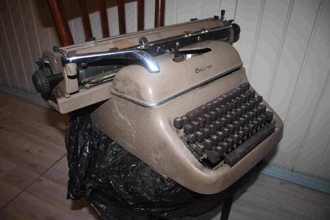

    I have two interesting ideas. I have an old Optima typewriter, which has been produced since 1950 in the German Democratic Republic in Erfurt on the basis of the Olympia Büromaschinenwerke company. I want to breathe a second life into it and make it so that it can be connected to a computer or to another device such as a phone or tablet. I think the Arduino will be enough for this.

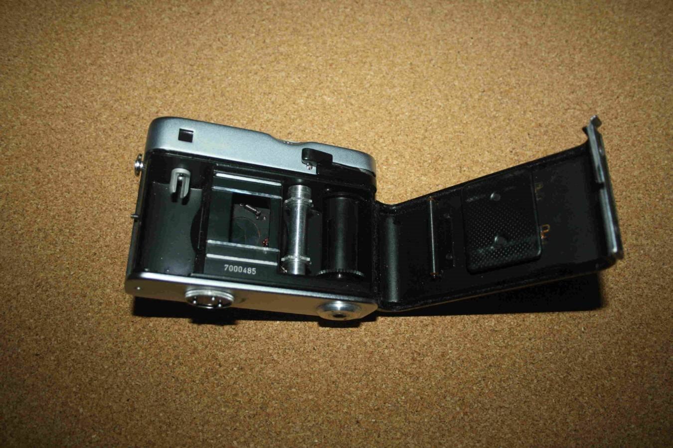

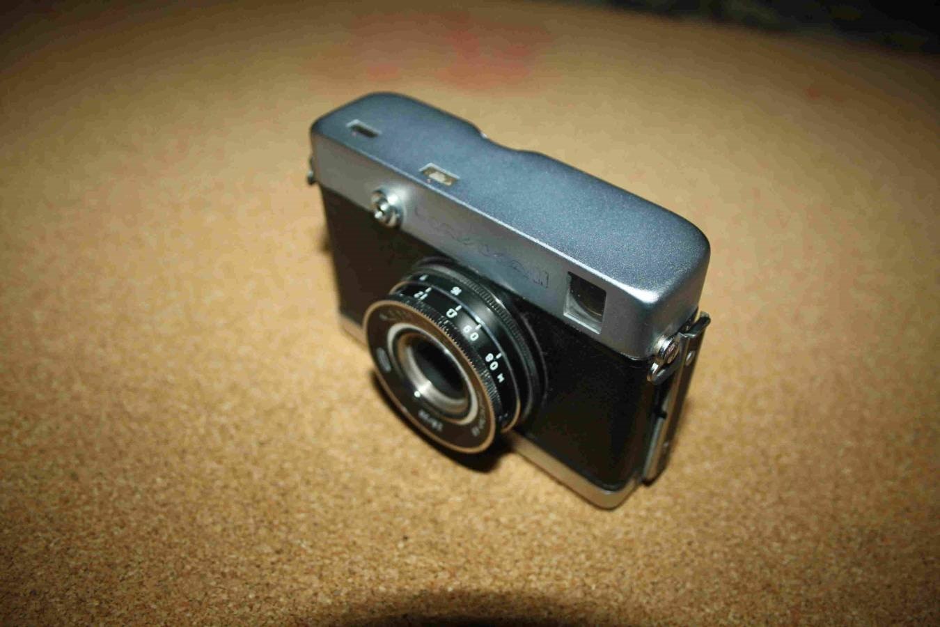

    I also have an old Soviet film camera "Chaika", these cameras were produced in 1965-1974 by the Minsk Mechanical Plant named after SI Vavilov in Bellarusia. I want to make a retro digital camera out of it. I want to try to put a Raspberry PI and a camera module in it.
    balearicdynamics over 5 years ago in reply to maxpowerr
    Both are good Ideas. But about the typewriter, what do you want to do? I mean, what kind "connecting" it to something else? Without more details it is not easy to suggest what micro or embedded device is better.
  • hugohu
    hugohu over 5 years ago in reply to balearicdynamics
    Hmm.
    RPI is better. You can have mechanical keyboards to a soft click keyboard, etc.
    A bluetooth typewriter?
    That wouldn't really be much better than a regular keyboard, not to say its weight and bulkiness.
    balearicdynamics over 5 years ago in reply to hugohu
    Frankly, I always think to upcycle something to make something else useful. A complex but probably almost inexpensive project maybe reversing the use. And yes, the Pi may be a better option due to the complexity of the original device.
    Enrico
  • maxpowerr
    maxpowerr over 5 years ago in reply to balearicdynamics
    Hugo Hu got it right. I am planning to make a bluetooth or wi-fi keyboard. The typewriter is really very heavy somewhere around 20kg. You won't move such a keyboard often. This is a thing for inspiration. You can select a small place in the house where you could put it, put a tablet or smartphone on top of it and print your story.
    I have already explored in past some of the possibilities to connect a sensor to every key of the typewriter but every solution I found was too complex, in my opinion. Recently during last months, I had the opportunity to explore deeply the characteristics of the Cypress Capsense technology and maybe this is a new way to upcycle a typewriter with a lower impact, then adding a mechanic to the already existing typing mechanism. Still thinking on how-to.
    Enrico
  • hugohu
    It isn't very complex actually. It can be done fairly easily, depending on how you do it.
    If you made a PCB with those silicone button things, that would be quite easy, in an array.
    Just hot glue a piece of the silicone switch onto the bottom, I'd assume.
    Hugo,
    easy as like as removing all the keys and replacing with buttons. But one of the "must" is that the vintage stuff should remain quite the same. Else there is no game image
    Then, just about the gluing of the buttons, there are no this kind of touch buttons one by one, and these are built with several layers of plastic, not a real PCB. So you can't cut or separate them so easily as you think
    dougw over 5 years ago in reply to balearicdynamics
    If you look at where the letter arms pivot out during a key press, you just need to measure the distance to the one that starts moving, so a single distance sensor might be enough for the whole keyboard.
    balearicdynamics over 5 years ago in reply to dougw
    Unfortunately no, Doug, already tested this method. Dring the movemenrs, both the keys and the hammers move non-linearly. To is it a problem to be able to discriminate the correct key.
    There are two options that until now for me seems promising, based on the tests I have done.
    One is optic, with a sensor per lever (but complex to make) one is contact, replacing the traditional Pb hammers with a contact. This is the only point where every single character goes to a precise and unique position (the mid of the lever, I mean, just to make the different hammers to reach always the same point of the paper.
    It is a good idea to remove the hammers BEFORE trying with a tablet instead of the paper sheet.
  • hugohu
    I have a typewriter in China, but I'm in the US so I can't think of stuff that might work.
    You say that most of the vintage stuff must remain, or else it's just replacing a 300mHz computer with a top of the line Xeon.
    I think I might have an idea.
    If I recall correctly, you have a bunch of small hammers hitting the paper. It will be a very small space but if you manage to cram some kind of sensor to detect the hammer hitting it, that would be nice.
    For the SHIFT key and other keys, well.... you could always add a button?
