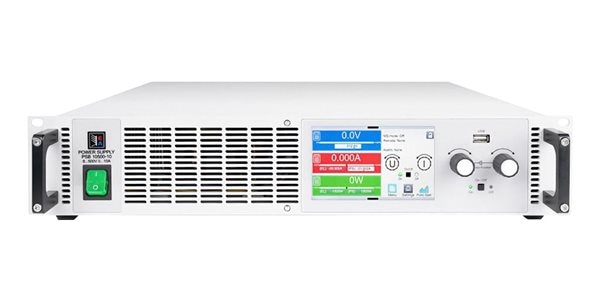

Figure 1
Figure 1. EA-PSB 10500-10 2U, 0-500V, 0-10A, and 1.5kW  (Image source)

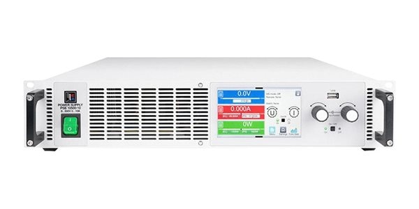

Figure 2
Figure 2. Single-chassis solution of a bidirectional power supply that can both source and sink power (Image source)
On the other hand, a bidirectional power supply works both ways. It can seamlessly switch between sourcing and sinking power within one unit. For example, it can charge a battery at 4.2V and discharge it at 500mA without changing equipment. Unlike standard supplies with fixed limits, its auto-ranging feature delivers full power across a wide voltage and current range. It’s also regenerative, converting absorbed energy back to AC and returning it to the local or facility grid with over 96% efficiency.

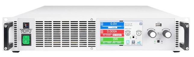

    Figure 4
    Figure 4. Integrated function generator enabling advanced waveform simulations for power testing (image source)

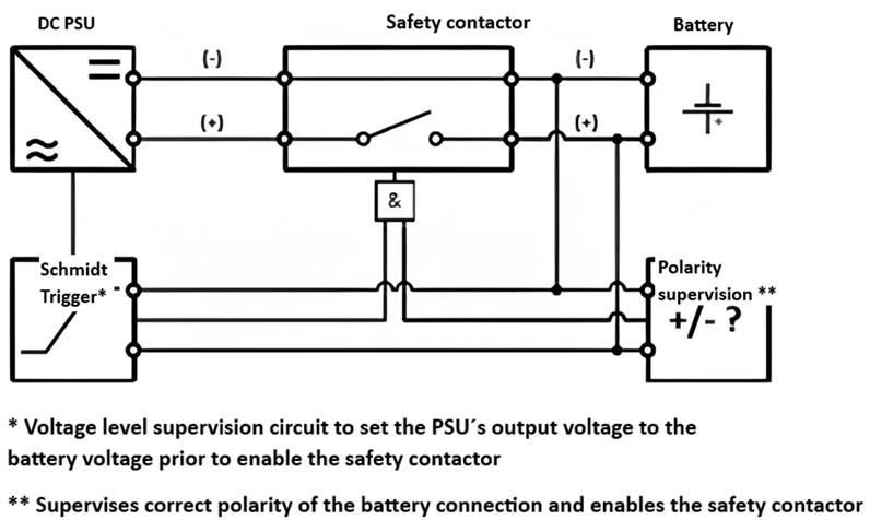

  • Battery testing and simulation: The EA-PSB 10000 series is ideal for testing EV batteries at cell, module, or pack levels. It supports State-of-Health (SOH) classification, End-of-Line (EOL) testing, and integrated battery diagnostics. With precise voltage/current measurement, high reproducibility, and over 96% efficiency, it fits both automated systems and standalone setups. These power supplies also simulate single cells, modules, or whole battery packs for evaluating storage configurations and DUT performance. Built-in OCP, voltage monitoring, and alarm functions ensure safe and accurate testing, acting like a virtual battery with protective features.
    Figure 6
    Figure 1. Ideal setup for high-power battery charging and management using bidirectional programmable DC power supplies (image source)
