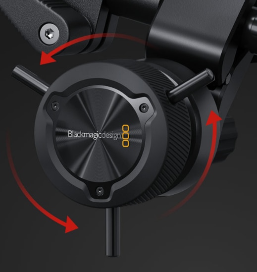

  • beacon_dave
    beacon_dave 1 month ago in reply to dang74
    I have some puck-like remotes for my video cameras which allows you to move the lens focus control down onto the tripod head handles
  • dang74
    dang74 1 month ago in reply to beacon_dave
    That would be cool.
