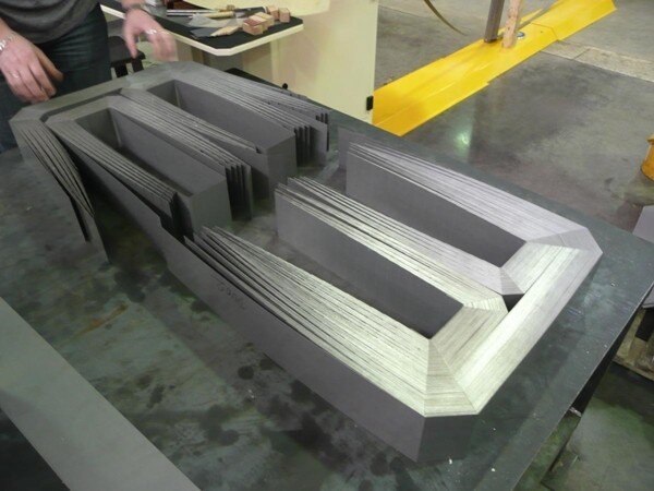

The transformer's core is the principal part of any electronic and electrical system. By its efficiency, the effectiveness of the secondary and primary windings depends on how the electrical impulse reaches the system. Many people know about the equipment's estimated scheme of operation, can call the mechanism's key features. Yet the question of why the core of the transformer is constructed from separate plates finds no answer.
The truth is that there is an electrical impulse applied to the material, and there seems to be no difference whether it is fixed or multiple. Therefore, in a simple language, we will seek to illustrate as easily as possible why the transformer core is constructed from thin sheets, why it is necessary and how the length, width, and conductivity coefficients are chosen correctly.

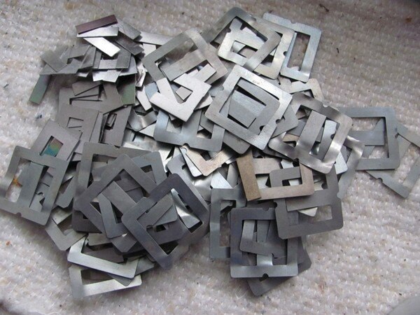

The system consists of solid tiles, of varying thicknesses. You can make various product variations: from 0.5 to 0.35 millimetres, but you can also find another sheet of thickness. Cold-rolled and hot-rolled variants are distinguished by improved magnetic circuit characteristics but the assembly of the unit involves different work skills.

Devices from thin and different core plates need to be assembled-this eliminates vortex losses. They become deformed under the influence of magnetostriction on the transformer, the performance is decreased, high-quality power measurements and other technological features are impossible to carry out.

Having learned how the core works and understanding its main technical characteristics, materials of manufacture and design features, you can understand yourself why the core of a modern transformer is assembled from separate sheets of iron. In order to understand this, you need to trace the opposite. If the core of the equipment was made of a solid solid piece of metal, this would lead to the appearance of an alternating magnetic field.
This in turn encourages the formation of a substantial magnetic field near the core. Emerging additional currents are not needed for stable and high-quality operation of the vehicle, they only complicate the processing of data by the secondary and primary windings.

    The cores are constructed from thin laminated sheets (of silicon steel) to prevent circulation currents (eddy currents) which cause heating and energy loss within the core, decreasing the transformers efficiency.  Here is a link to a good article on this subject:
    https://www.electronics-tutorials.ws/transformer/transformer-construction.html
