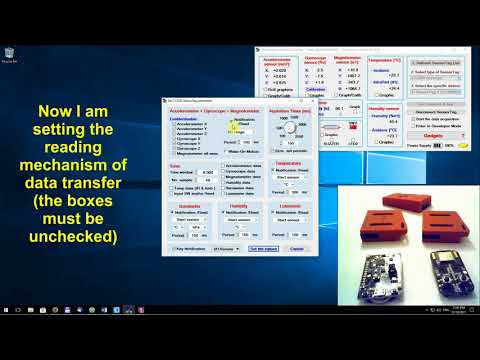

Windows 10 - Anniversary Update - Version 1607
This version of the Windows 10 operating system is the best one, from the point of view of Bluetooth Low Energy devices. It can pair without any problem with all SensorTags (regardless of the software version running on them), with which blessTags application knows how to work (CC2650STK, Thunderboard React, Thunderboard Sense and CC2541DK), and all the information from the Bluetooth’s Services Get Generic Access and Get Device Information is acquired without any problem.
Analyzing the data acquisition speed (for CC2650STK and CC2541DK devices ) using notifying and reading mechanism of data transfer, we can observe the following:
  1. through the notification mechanism, we can get data from all sensors (eight) from 150 [ms] to 150 [ms] without any problems;
  2. instead, when we set the acquisition time to 150 [ms] and we use the data reading mechanism - in the happiest situation, we get 713 [ms] and in the worst case, we get 840 [ms].
If we will analyze Thunderboard React and Thunderboard Sense, we will get the equivalent results – they work without any problem in the Windows 10 Anniversary Update environment.
In fact, all the presentation movies of the blessTags application main functions and of the different specific features (like Gadgets) have been made with the support of the Windows 10 Anniversary Update.
A small demonstration and a proof of the above statements in the following movie:

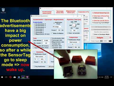

Windows 10 – Fall Creators Update - Version 1709
This version of Windows 10 (1709 – OS Build 16299.19) is a huge step forward, compared with Windows 10 Creators Update (were on BLE almost nothing is working), but still has a long way to get to the level of Windows 10 Anniversary Update (1607) operating system.
But let's see why I made this statement:
  • CC2650STK (firmware version 1.40) & CC2541DK:
I will treat these two devices here simultaneously because their behavior related to the Windows 10 (1709) operating system is similar.
The pairing operation and the reading, from the Generic Access and the Device Information services, are working perfectly without any kind of problems.
The problems only occur when we want to read information from the sensors. The data transfer mechanism through notifications does not work at all.
The only way to get data from the sensors, embedded in the SensorTag, is by means of the direct reading mechanism from the device. This approach has two issues: (1) lower data transfer speed (as we have shown above) and (2) if all the sensors accept one of the two data transfer methods (through reading and notification), the buttons on the SensorTag can be interrogated only through the notification mechanism. Thanks to this "feature" of the Windows 10 (1709) OS, the blessTags application implements, starting with version 9.7.8.0, the reading method for data acquisition also.
A problem appears with the  CC2650STK SensorTag having the firmware version 1.20. If the process of pairing and data reading from Generic Access service works very well, the reading process from Device Information services is not possible. Moreover, the sensors reading (from this SensorTag with this firmware version) does not work through either one of the two possible mechanisms (reading or notification).
  • Thunderboard React:
In the same mode like in Windows 10 Creators Update, the SensorTag appear and disappear when we want to add a new Bluetooth device. The same behavior can be highlighted in the action center on Bluetooth’s quick action button were “Not connected" and "Thunderboard React" are displayed repeatedly (please see in the following movie this process starting from the time index 5.14 s). Immediately we can conclude that Thunderboard React is guilty, mainly due to a flawed implementation of the advertising mechanism by Silicon Labs engineers. But, searching on the internet, we will notice that other users reported the same problem to other types of BLE devices, after installing the Fall Creators Update – e.g. view this movie on YouTube.
After pairing the SensorTag, the blessTags application is not able to find the Thunderboard React device. So, at this point nothing is working:  Generic Access and the Device Information services or data acquisition from the sensors embedded on Thunderboard React SensorTag.
  • Thunderboard Sense:
The mode to behave is similar to the one of the Thunderboard React. This Bluetooth device is displayed and disappears repeatedly. When the pairing process succeeded, it is possible to take data from Generic Access Service. But from this point, nothing is working anymore.
As a conclusion, up now on Windows 10 Fall Creators Update (1709, build 16229.19) only the SensorTags produced by TI (CC2650STK and CC2541DK) are working. More, they are working only in reading mode But attention Only  CC2650STK firmware version 1.40 will work in this mode Unfortunately when you buy a  CC2650STK you have a very high chance of taking a device with firmware revision 1.20. So, to be able to communicate with a such a type of SensorTag an upgrade it is necessary at least to the firmware version 1.40.
Below I present a movie that proves all these statements made above for Windows 10 Fall Creators Update.
Since the first release of Windows 10 Fall Creators Update (build 16229.19), on October 17th, 2017, there have been no improvements or errors corrections related with Bluetooth LE up to KB4054517 (released on December 12th, 2017). In KB4054517 (OS Build 16299.125) there is a key change on Bluetooth LE (see here): “Addresses issue with personalized Bluetooth devices that don't support bonding”. Since this message is very cryptic, I've decided to resume all my analysis donned so far and to see if there are any improvements compared to the first release of Windows 10 Fall Creators Update (build 16229.19).  … and a little surprise, right now I am able to get: (1) data from Thunderboard Sense (from the sensors embedded on the SensorTag but only through the reading mechanism) and (2) all the information from Generic Access and Device Information services. There are no other improvements.
