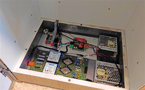

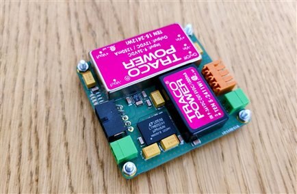

This that first project that used FPGA. I want to learn how to create custom electronics with it, and hardware for me is not a problem. I made boards with 800pin FPGA's for other to program image All programming is done via schematic implementation, so no need to write code, just place parts from libraries to form SPI shift register or do some basic math to scale register value to nonlinear voltage that x-ray generator is using for energy set-point. Power supply is generated from 24V, i need 5V 5A for Hamamatsu sensor, isolated +12,-12,+5V for X-ray generator, and another 12V for controller board as well as stepper drivers.
And here is how it looks all inside machine imageimageimage
