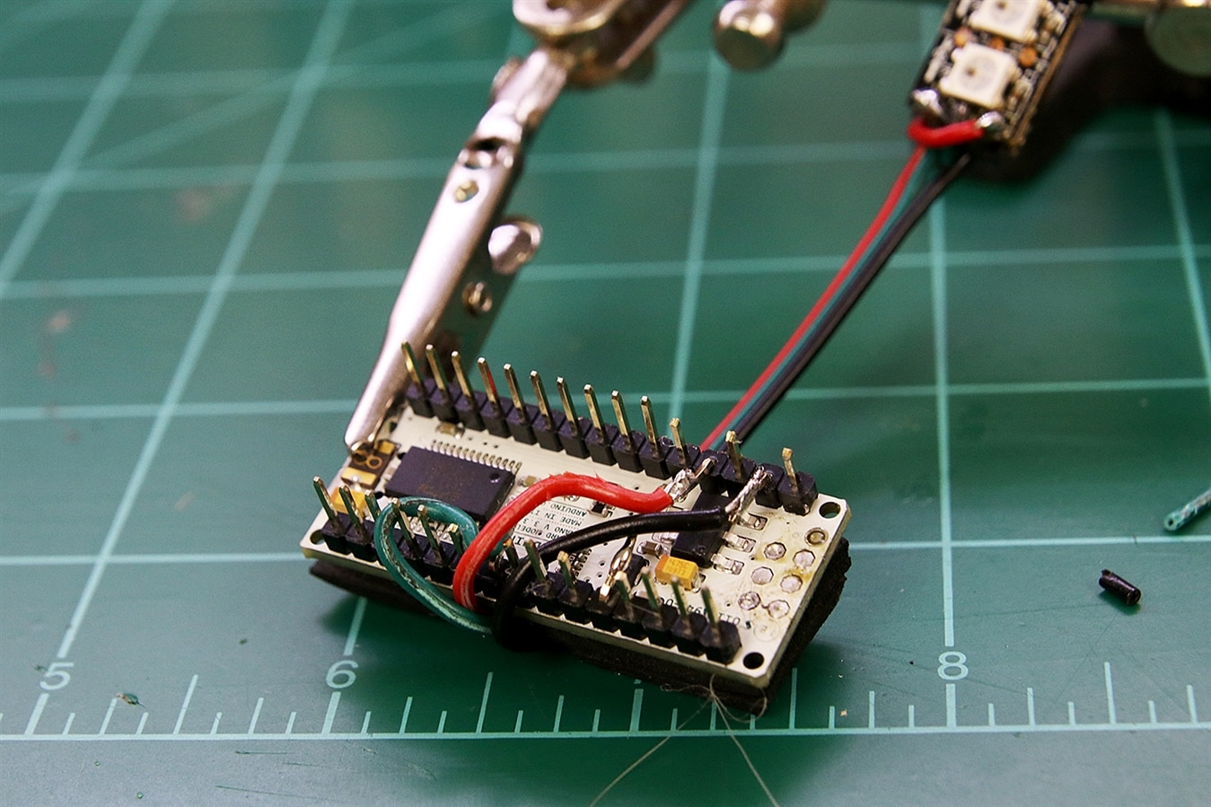

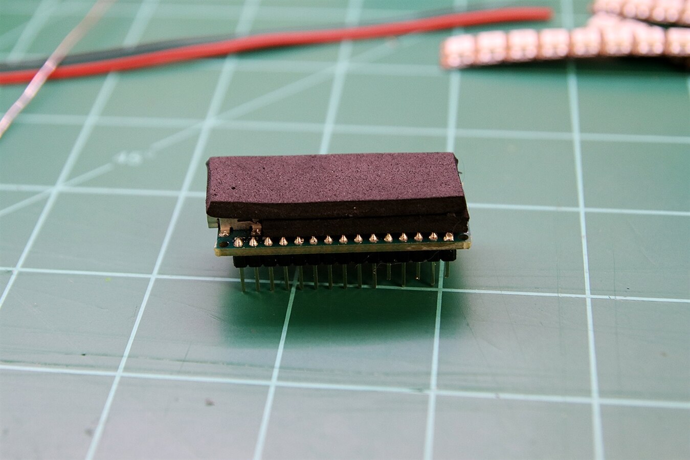

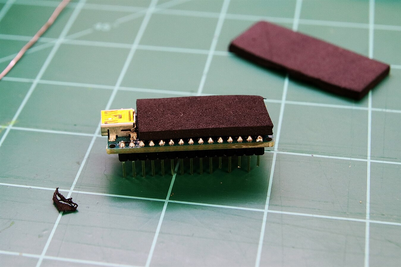

Hardware
To complete this tutorial you will need the following items:
    • 1x Arduino Nano V3Arduino Nano V3
    • 2x Adafruit Neopixel SticksAdafruit Neopixel Sticks
    • 1x Hookup WireHookup Wire
    • 1x Tall Tactile Push Button Tall Tactile Push Button
    • Black Craft Foam (Sourced Locally)
    • Vellum or Tracing Paper (Sourced Locally)
    • 1X Lantern (Sourced Locally)
Software
To complete this tutorial you will need the following software. Click the links to open their download pages in a separate window.
    • Arduino IDE
    • FastLED Library
    • Source Code For This Project
Tools
You will also need the following tools.
    • Soldering Iron & Solder
    • Hot Glue Gun & Glue Sticks
    • Drill & Drill Bits
    • Scissors or Xacto Knife
    • Needle Nose Pliers

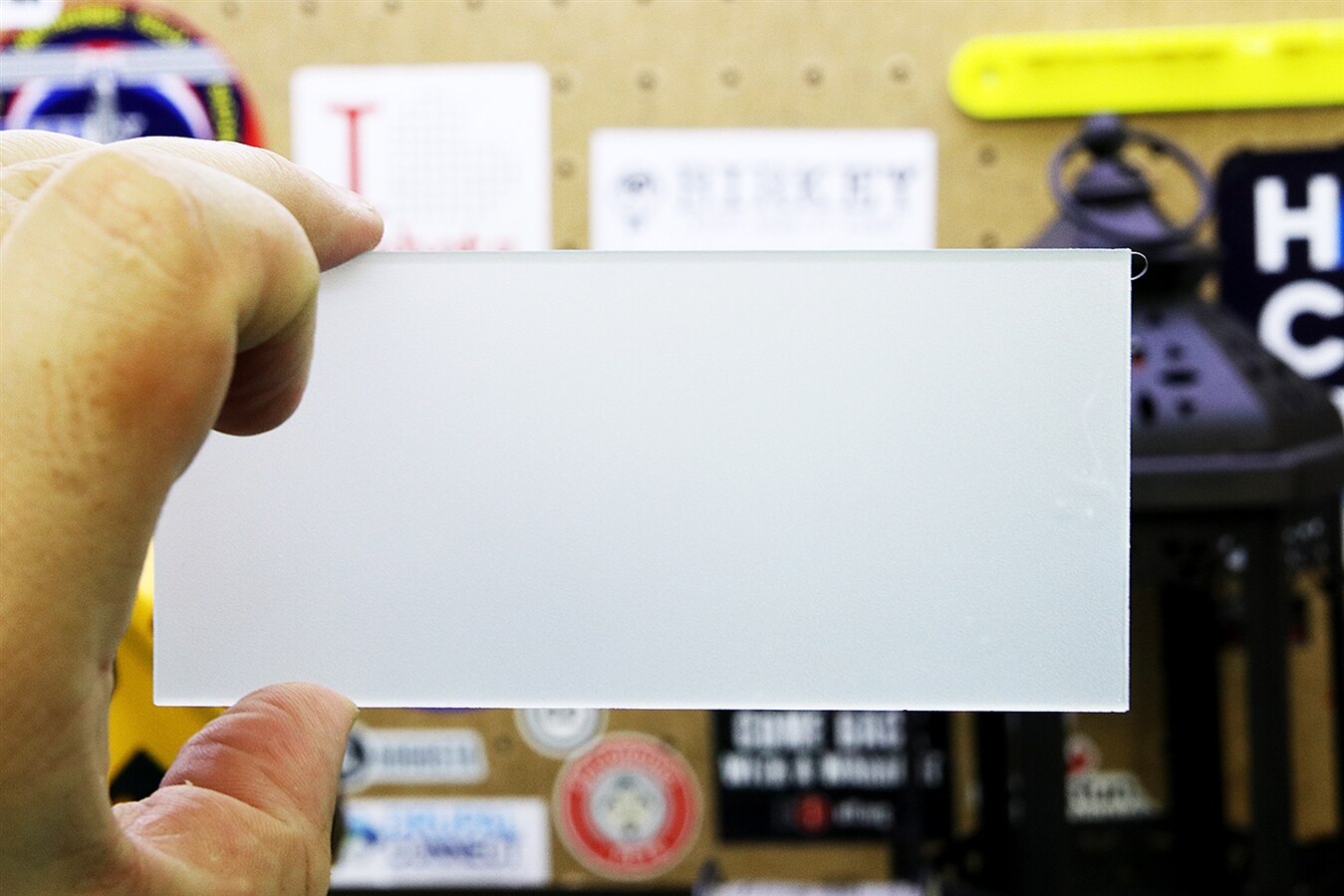

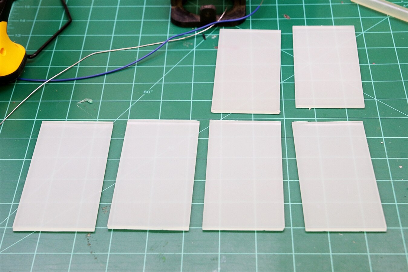

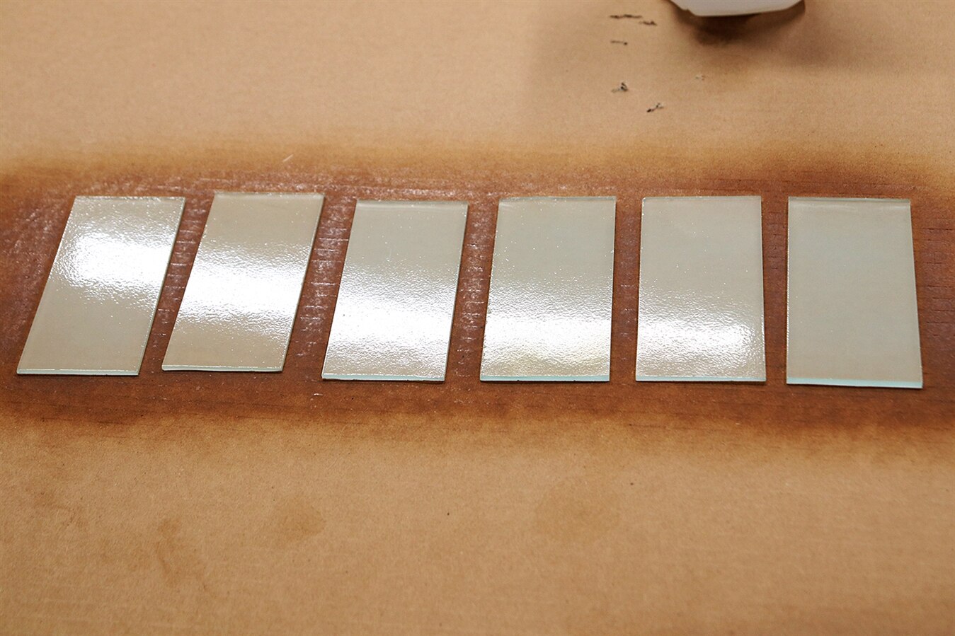

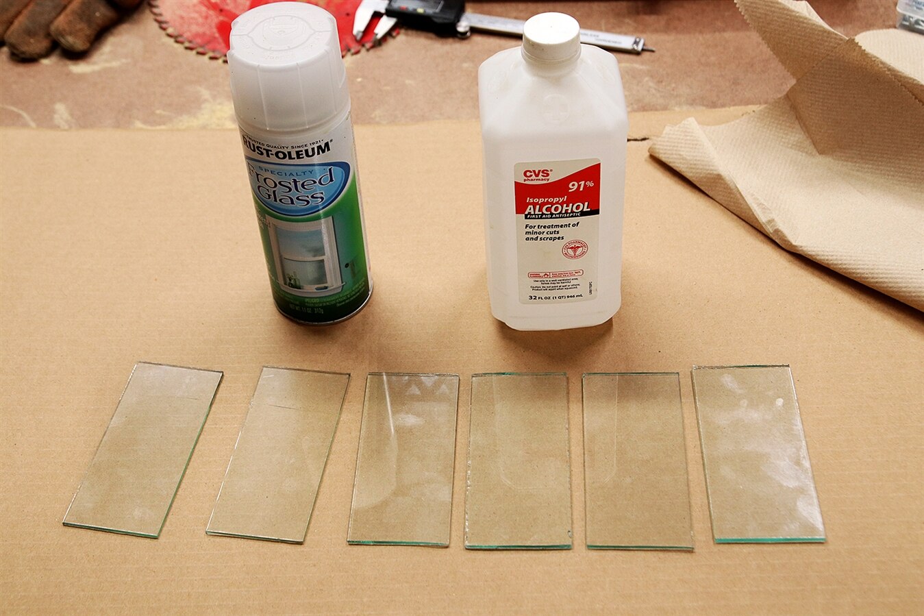

To get started, we need to remove the glass panes and prep them for the frosting spray. For this particular lantern and most others like it, each glass pane is held on by four small metal tabs, as seen in the image above, that will need to be folded back to allow the pane to be removed. The glass pane’s are usually quite sharp, with their edges chipped from rough handling at the factory, so be careful, and consider wearing gloves when removing and handling these glass panes.
With the glass panes removed, you can see how sharp and jagged their edges are. Now take the panes outside, or somewhere that is very well ventilated as the frosting spray produces noxious fumes when drying.
To ensure that the frosting spray achieves good adhesion the glass needs to be free of any oily residue from handling it. I have found that using 91% isopropyl alcohol is best for cleaning the glass. I just wipe the glass with an alcohol moistened paper towel until the fingerprints disappear, then wait 10 minutes or so to ensure that all of the alcohol has evaporated.
With the glass clean, I held the frosting spray about 10-inches away from the panes and sprayed a nice wet coat onto the glass. The instructions said to wait about 7 minutes and apply another wet coat. Then I waited for about 10 minutes and added another coat, this time about 14-inches from the surface and lighter than the last two. I repeated this step three more times until I was happy with the opacity of the panes.

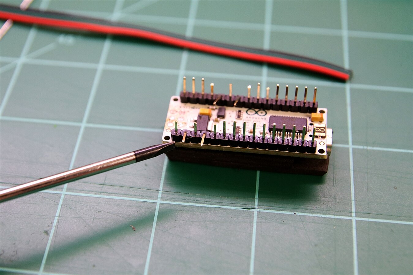

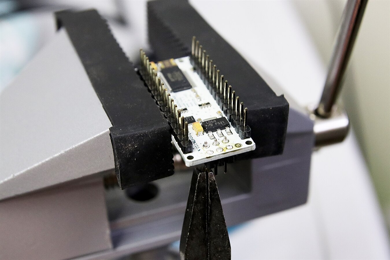

Before we get started wiring things together, the official Arduino Nano V3  comes with its header pins preassembled. I prefer to get the boards unassembled, but that is only possible with the off-brand variants of the nano. Because of this, the SPI header makes the nano a little too tall for our project, so I need to remove the six pin header on top of the board.
To do remove these pins, I clamp the board in my small bench vice, and use my soldering iron to heat each pin’s solder joint while pulling on that pin with a pair of small needle nose pliers. Once the joint reaches molten temperatures, the pins pull right out. When doing this yourself, remember to not clamp the board too tight, as you could cause it to flex and break loose the surface mount connections of the small ICs and passive components.
Here you can see that all of the SPI header pins have been removed, and nothing but small solder balls are left on the pads. I should have done this to the entire board as doing so would have provided me with a cleaner install. When I originally designed this project several years ago, I actually used Arduino Pro Mini boards which come with the header pins unsoldered. Eventually I developed my own purpose built PCB for this project, but that board was proprietary to the company I used to own, so unfortunately, I can not share it here. I could design a new board if there is enough interest though.

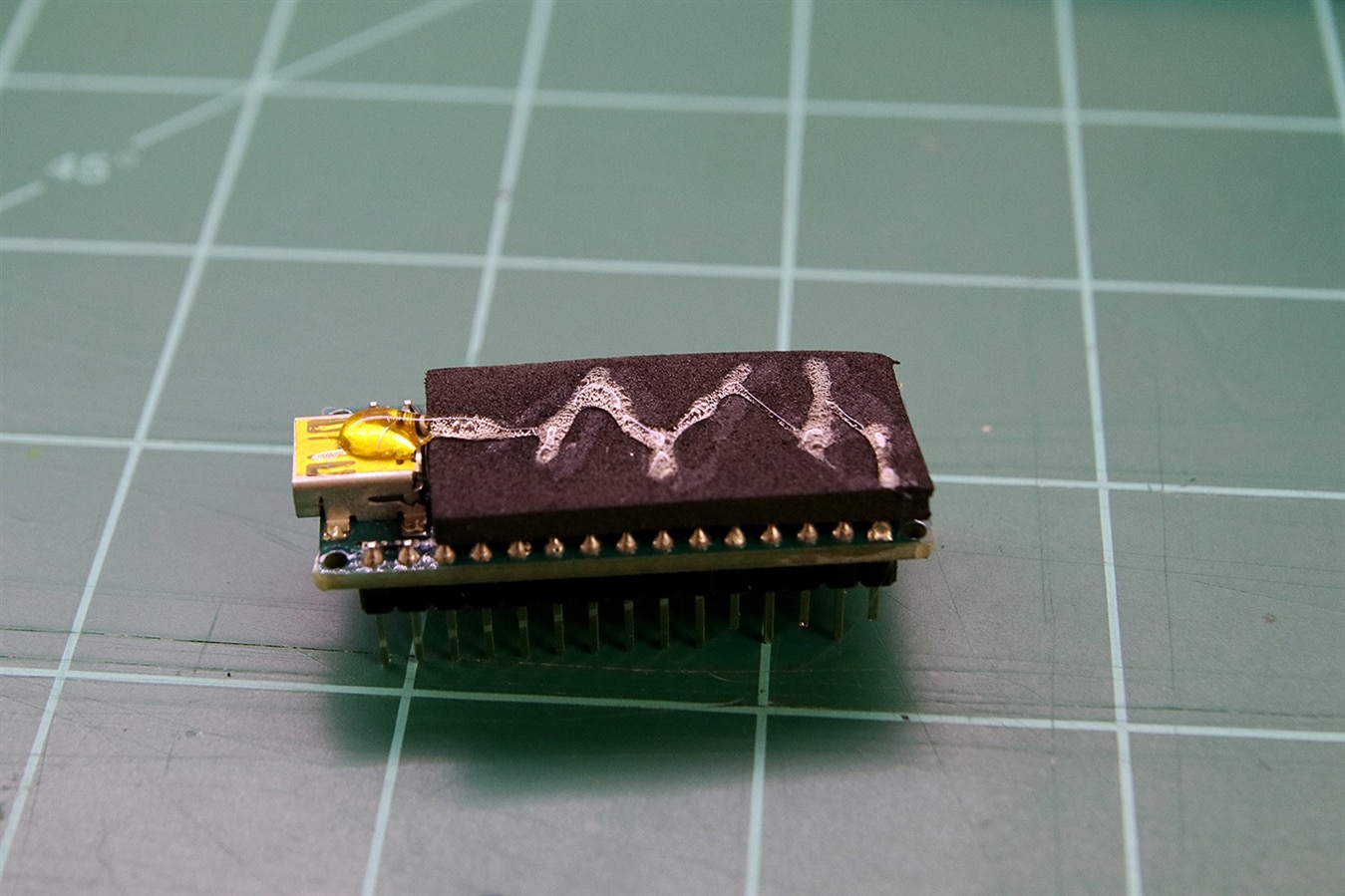

While we are modifying the Arduino Nano to better fit our project, we need to cut some small strips of black craft foam which we will hot glue to the Nano’s surface to insulate it from the metal bottom of the lantern. Since the USB port sits several millimeters proud of the PCB’s surface, I cut a smaller piece of foam to help level things out for the larger piece which will cover the full surface.
Here you can see how I glue the foam to the Nano to ensure that the final result is nice and flat. It is important to note that you should not cover the Nano’s reset button with hot glue, and make sure to not depress it when pressing the foam into the glue. If you accidentally get glue on the button, just let it dry and remove it with your fingers or the needle nose pliers. Also note that I used two very small drops of glue on each end of the small strip of foam for this very reason. Once the glue has dried, try depressing the button. It should click, which is an indication that it is not stuck with glue.

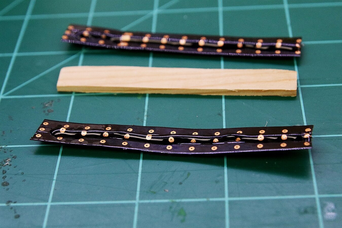

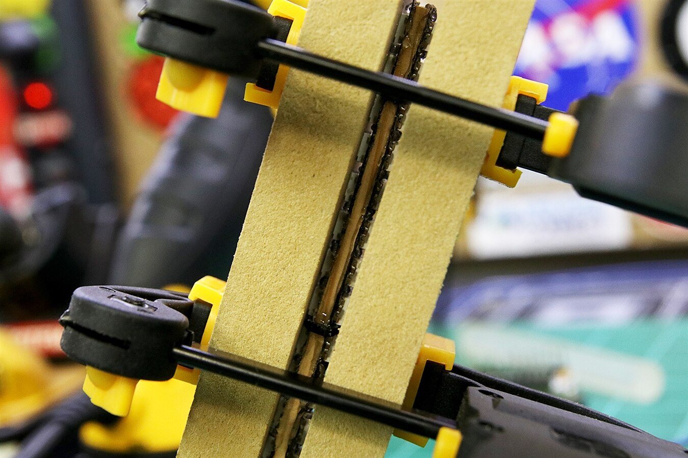

Let's begin by focusing on the Neopixel sticks / strips. Since I am using flexible strips that have been cut into 4-inch long pieces, I need to add something rigid to them to ensure they stand up nice and proud later in the build. I simply use a popsicle stick that I cut with an x-acto knife to be slightly thinner and shorter than the strips. Typically, the only glue that will bond to the strips is something super tacky like E6000, which just so happens to be my third favorite glue, and something I stock in my workshop by the half dozen. If you are wondering, Cyanoacrylate (CA) and hot glue are my other two favorite types of glue.
I spread a small thin line of the glue across each strip, and then sandwiched the popsicle stick between the two strips. E6000 is quite the potent glue, and it would be advisable to have a small fan running near your workbench to avoid over inhalation of its fumes.
To ensure that the strips stayed oriented on the popsicle stick, I used a pair of small zip ties to secure them to the stick. Then I placed the sandwich between two scrap pieces of wood, and used small clamps to apply gentle pressure until the glue cured about an hour later.
Here you can see a closeup of the stick once it had cured and was ready to solder some wires to. I decided to leave the zip ties on for added insurance.
I forgot to mention earlier that you should orient both strips so that their Data In pins are on the same end of the stick. This makes wiring up the Neopixels a little more difficult, but it is necessary to achieve the effect we are going for.
I pre tinned the hookup wires before soldering them to the Neopixels. In the second photo (click to enlarge) you can see how I hook the strips together. Since the strips are mirrored from each other, I need to cross over the 5V and GND lines, but the Data In pin remains in the middle. This process is much easier with the Neopixel sticks than it is with these high density strips which have very small solder pads.

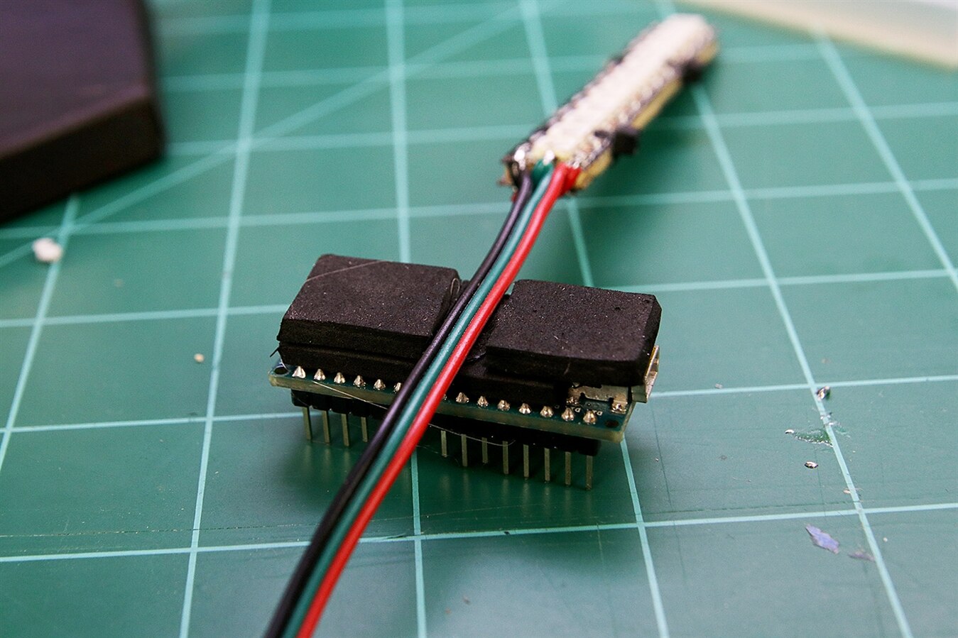

Before we solder our wires to the Arduino Nano, cut a small passageway into the top of the foam. This will allow us to pass the Neopixel’s wiring under the Arduino when installing the electronics.
In an attempt to make the install even more low profile, I decided to bend over the pins I would be using, which would allow me to lay the wires down instead of having them stick up and possibly create shadows. As I mentioned earlier, this was a mistake, and I should have desoldered all of the pins from the board, and soldered the wiring directly to the pads. This would have resulted in a much cleaner install, but I guess you live and learn, and in reality, no one will see the mess that is to come once the lantern is finished.
With the pins bent over, it's time to solder the Neopixel’s wires to the Arduino Nano. Refer to the diagram above if you forgot which pins each wire connects to. You can see here how messy this looks, but it's functional, and will not be visible in the completed project, so it's not that big of a deal honestly.

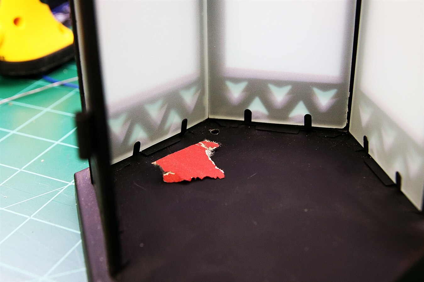

Installing the panes is as simple as reversing the steps you took to remove them. This time you need to be very careful as to not scratch the frosted coating on the lanterns sharp edges. It’s also worth noting that if you have sweaty hands, this would be a good time to wash them and wear gloves, as the oils from your skin will visibly stain the frosted coating.
Here you can see the difference in the frosted glass versus the clear glass. The clear glass is nice when using an actual candle, but since we are using LEDs it must be frosted to hide the electronics. I actually prefer the frosted look myself. This would be a good time to point out that I chose these lanterns because of the one inch tall wall at the bottom. This wall is tall enough to hide the shadow that will be cast by the LEDs when illuminated. Keep this in mind when choosing your lantern. Alternatively you can hide the electronics in the top of the lantern and uncomment the line near the top of the code that will reverse the led animation’s direction of flow, which will allow you to hang the Neopixel sticks from the top, and it still look like the flame is flickering from bottom to top.

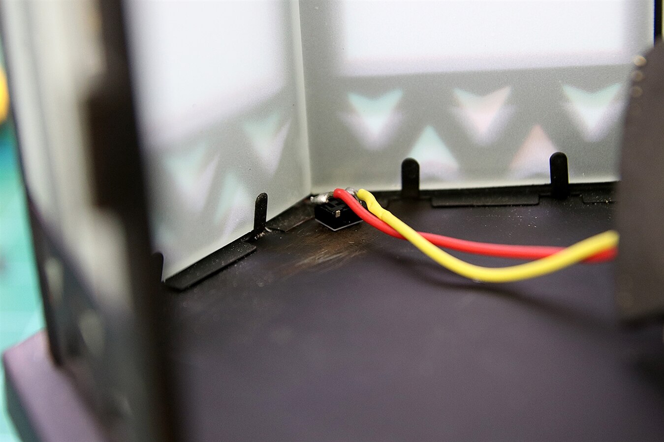

Now let's begin installing the electronics! The first thing we need to attach is the button, and that’s quite simple to do! Place the button in the small hole, and then cover it in a nice thick layer of hot glue, then hold in place using the wiring until the glue solidifies. Try your best to not get any glue between its mandrel and the button body itself as this could prevent it from working.
Now apply a small strip of hot glue to the corner closest to the back of the lantern in relation to the middle of the door. Then press the USB cable into the hot glue making sure to leave just enough room to connect it to the Arduino Nano.
With the USB Cable in place, its time to use two small dabs of hot glue to secure the Arduino nano in place. Plug the USB cable in before doing this. If you are worried about the cable pulling out through the top, you can zip tie a ½-inch steel nut to it in top of the lantern. I have found the hot glue to be sufficient though.

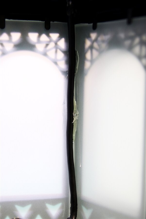

Installing the Neopixel sticks is a little bit tougher than the other components and it requires a steady hand. Once the stick has been placed as close to the center as possible, I use my glue gun to apply hot glue from the first pixel down. I make sure that some of this glue actually coats the first pixel, which gives it a bit more rigidity. Once this first layer of glue is solidified, I add another layer making even more contact with the stick. Note that I did not include a photo of the surface of the lantern under the stick. I scuffed it up with 80-grit sandpaper before applying the glue. After 2 or 3 layers, the stick should be stuck firmly into place, and very rigid. It is important to ensure that no metal from the solder connections are touching the metal surface, and you can add a thin layer of hot glue to the surface before gluing the stick in place if you are worried about this.
Now we need to take the velum paper and create a small cylinder shaped diffuser. This is necessary because the frosting on the glass is not enough to fully diffuse the circular light pattern the LEDs project. Since the stick is about 4-inches tall, I made my diffuser about 5-inches tall, and secured its ends together with a piece of double sided tape. Glue will work fine here as well, but you want the thinnest layer possible to prevent a dark spot in the diffuser.
Since the blob of hot glue holding the Neopixel stick up is so large, I had to cut out some of the diffuser on the bottom to make it fit. I got it as close as possible, and even though a few gaps were showing, I knew that it would be pointed towards the back of the lantern and not visible from the front.
To secure the diffuser in place, I used a few dabs of hot glue. With this in place, we simply need to hook up our USB cable to a power source and things are finished. I did notice that the lantern’s brightness was a bit high, so I plugged the USB cable into my PC and adjusted the brightness to about 125 by changing the code near the beginning of the code.
