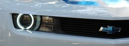

    Brilliant project. I've just discovered that they use 3w LEDs to do the halo lighting on the front of some modern cars. Obviously someone has worked out changing to a 3w RGB gives another dimension, and…

    I think your Bemmer is a bit old to have halos ...
    shabaz over 10 years ago in reply to mcb1
    Cool idea : ) The RGB Shield looks ideal for that, especially for shows..
