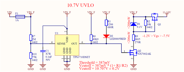

3.1 Under Voltage Lock Out (UVLO)
With the specification set in section 3 the subsystems were designed to meet this criteria. The following section breaks down the schematics and explains the teams thoughts and ideas about part selection.
After selecting some outlined components for certain parts of the project, such as an SD card reader to allow for data logging, it became apparent that we would need multiple voltage sources. In order to satisfy this and keep the project mobile, the team decided to settle on powering the system via one lead-acid car battery (12.6 V) which could be cascaded through a series of regulators and converters to meet all the power supply requirements. The main concern from this was the inherent danger of over-discharging a lead acid battery. By having unregulated charging and discharging the cells that make up the battery can be damaged, thus increasing the internal resistance of the battery. This can cause difficulties re-charging and in the worst case scenario causes a short between multiple cells, not to mention shortening the batteries overall life.
In order to solve this problem it was decided to implement Under Voltage Lock Out (UVLO) protection. This will disconnect the battery from the circuit when discharged below 10.7 V.
The first of these circuits is shown in Figure 4. This circuit is a Under Voltage Lock Out (UVLO), that means that if the sense input (pin 4) is less than 400 mV (i.e. the Lead Acid car battery voltage is 10.7 V), the whole system will shut off to protect the battery from over-discharge. The voltage divider values can easily be calculated from the data sheet. Using equation one;
Vmon = (1 + R1/R2) * Vit
During normal operation conditions (Vin > 10.7V), the OUT (pin 6) will be open-drain (floating), this will 'turn on' MOSFET Q2 via a pull-up resistor (R8), which pulls the gate pin of Q1 to 0 V and turning on the P-MOSFET (Q1). A 9.1 V zener diode prevents a Vgs of less than -8 V across Q1, limited by a 270R resistor (R9)
If under voltage conditions are met (Vin < 10.7V), the OUT pin will be pulled to 0 V. This will 'turn off' Q2 and therefore the Q1 will be switched off. This cuts-off the output to the rest of the circuit and turns on a red LED (D2) as a warning.
Figure 4 - Schematic for the first power stage - A simple Under Voltage Lock Out circuit

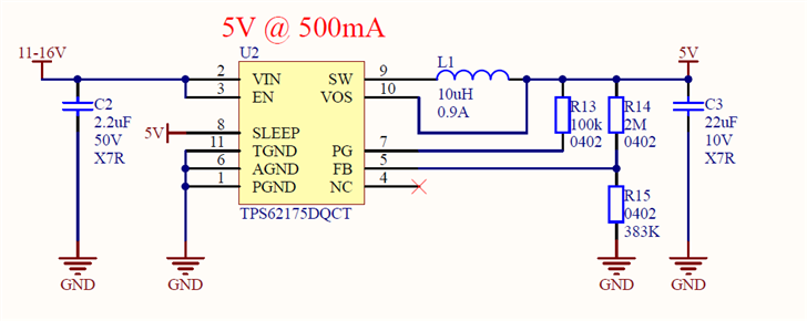

3.2 Arduino Regulated Supply
With the design being planned to run an arduino from a 12.6V car battery, it was necessary to create a lower voltage regulated supply for the arduino. The team decided to use a DC-DC switching buck step down regulator. The component was chosen as it met the required input and output voltage range (11-16 V) and was fairly efficient.
The supply works in a similar manner to other buck converters, that is the input DC input is switched on and off at a high frequency, this is used to charge the inductor and stabilize the output. The ratio of R14 and R15 defines the voltage output as seen from the data sheet. Capacitors C2 and C3 help to further stabilize the input and output voltage through the smoothing effects of capacitors.
An important point to mention the team feels has been left out by a lot of electronics guides is capacitor de-rating. In industry, it is common practice to increase the voltage rating of a capacitor to at least double the maximum voltage it will be exposed to. This explains why C2 and C3 ratings are much larger than the expected voltage. Capacitors are derated for two main reasons;
1. As a capacitor fills to its maximum rated value the capacitance value will significantly reduce.
2. The operating temperature of a capacitor is unlikely to remain constant, this will affect its capacitance and alter the maximum voltage, hence why all capacitors have a maximum operating temperature.
3. Capacitors like to blow up
Figure 5 - A 5V DC-DC switching buck step down regulator to power the arduino remotely.

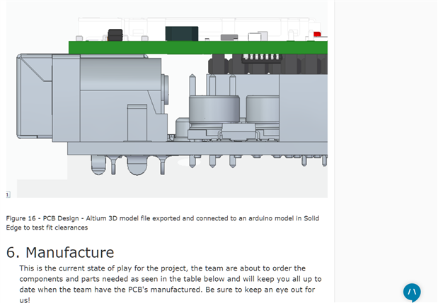

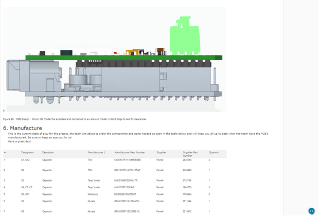

Figure 15 - PCB design - 3D model of the shield created in Altium Designer
Figure 16 - PCB Design - Altium 3D model file exported and connected to an arduino model in Solid Edge to test fit clearances
6. Manufacture
This is the current state of play for the project, the team are about to order the components and parts needed as seen in the table below and will keep you all up to date when the team have the PCB's manufactured. Be sure to keep an eye out for us!
