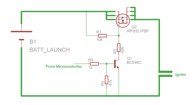

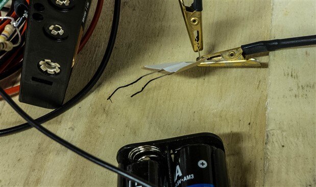

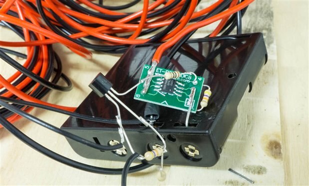

    0 shabaz over 11 years ago
    Hi Noah,
    I had some time to try out a quick non-relay circuit.
    I just used whatever components I had, and I've not done any calculations, so I'm not guaranteeing this circuit to work reliably always. However, I did test it since I had a little motor and a fuse spare. It was ignited outside the garage but the smell went everywhere : )
    This was the circuit:
    And this was the result afterwards:
    For the battery (BATT_LAUNCH in the circuit), I used 4xAA, i.e. 6V.
    For the microcontroller input, I didn't use a microcontroller. I just connected to a separate 3V supply to simulate that (I used 2xAA batteries for that).
    The fat wires in the circuit diagram need to be fat traces on the PCB.
    For safety, you should of course have a switch that disconnects BATT_LAUNCH until you're ready.
    With the circuit as described, you should be able to  connect it to any Arduino board and use it (but don't power the Arduino from BATT_LAUNCH, use a
    separate supply).
    Please use an existing Arduino schematic and modify slightly if required, there is no point re-inventing the wheel. This way you're almost guaranteed to have
    a successful project.
