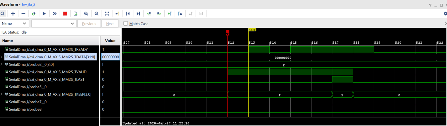

My application is to transfer a 32 bit from DDR (using DMA) to PL.
I connected the ILA to see the data at the m_axis_mm2s from axi_dma and it shows the m_axis_mm2s_tdata[31:0] always zero besides m_axis_mm2s_tready, m_axis_mm2s_tvalid and m_axis_mm2s_tlast seems ok.imageimage

  • maiatec
    0 maiatec over 6 years ago
    Solved !
  • clem57
    0 clem57 over 6 years ago in reply to maiatec
    Great! Can maiatec  elaborate with a sentence or two on how?
  • clem57
