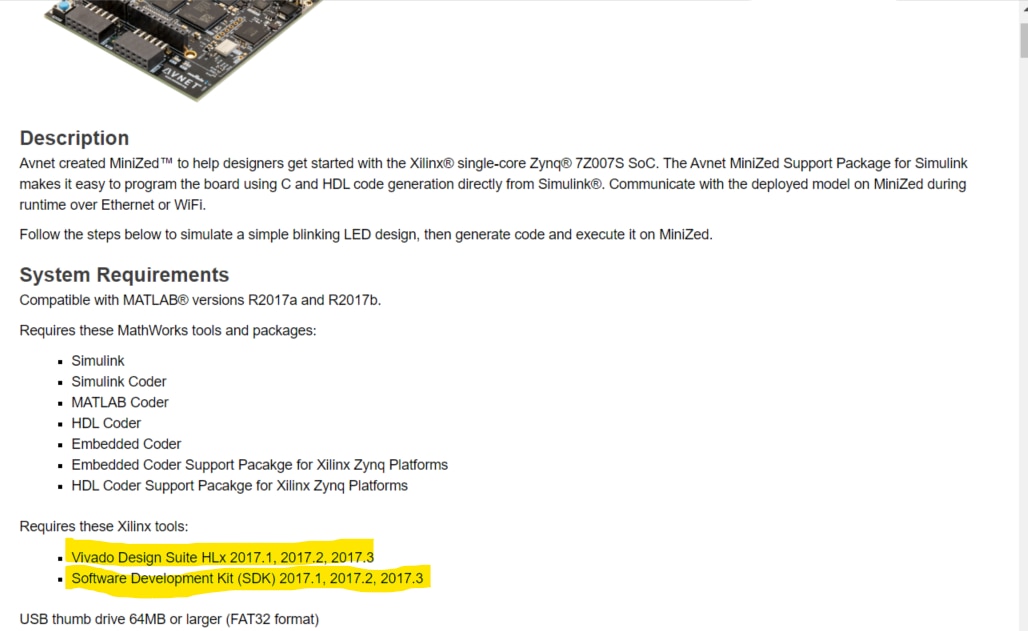

Hi All,
I'm trying to install Simulink support for the MiniZed board to try out the Mathworks development workflow. in the "Avnet MiniZed Support Package for Simulink\doc\GettingStarted.mlx document it says that the support package requires Vivado and SDK 2017 versions. Has anyone run this simulink support package with a later version of the Vivado tool and Xilinx SDK (specificially 2019.1)? Is this going to work?  See attached.
  • mbrown
    0 mbrown over 4 years ago
    Hi Tom,
    That's a big jump in versions. We often see things break between minor releases. You'd be jumping 2 major releases. I wouldn't expect it to work "out of the box".
    /Matt
