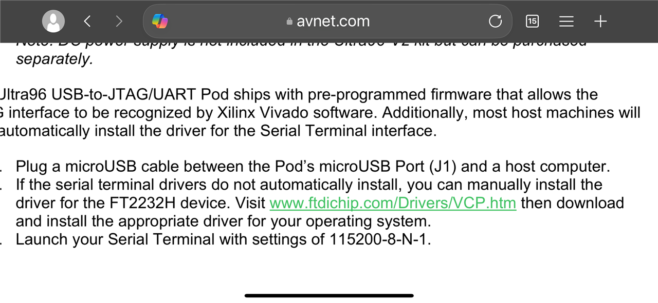

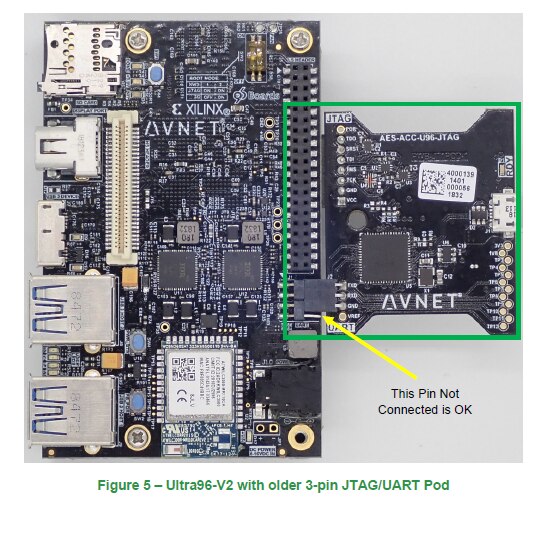

I’m using an Avnet Ultra96-V2-G Rev 2.1 board together with the Avnet JTAG/UART Pod.
JTAG debugging works correctly, but the UART serial communication through the same pod is not working — I am not seeing any UART output at all.
I expected the UART channel on the pod to provide the serial console, but there is no data coming through. I’ve confirmed that the target application is running, but no serial output appears.
Has anyone successfully used the JTAG/UART Pod for UART communication on the Ultra96-V2?
Or can someone confirm whether the Ultra96-V2 actually routes UART signals to this pod connector?
Any guidance or clarification would be appreciated.
  • iksevas
    0 iksevas 5 months ago
    From the user guide, do you have the FTDI driver loaded?
