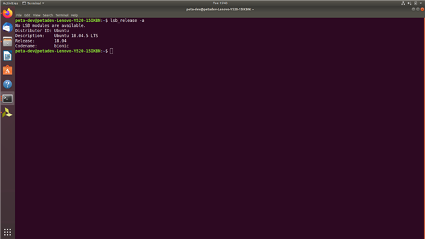

I work with Vivado 2020.1 and petalinux 2020.1, also ubuntu 18.4.

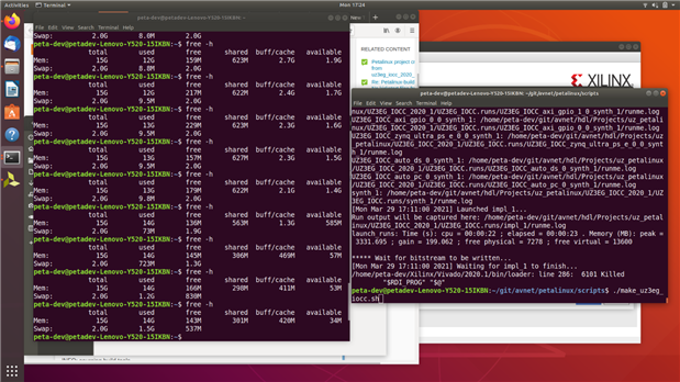

***** Wait for bitstream to be writen...
[Mon Mar 29 13:20:16 2021] Waiting for impl_1 to finish...
/home/peta-dev/Xilinx/Vivado/2020.1/bin/loader: line 286: 6390 killed "$RDI_PROG" "$@"
I check RAM in my Ubuntu PC :
peta-dev@petadev-Lenovo-Y520-15IKBN:~$ free -h
total used free shared buff/cache available
Mem: 15G 2.0G 11G 645M 1.9G 12G
Swap: 2.0G 0B 2.0G
When vivado synthesise:
Again I check RAM in my Ubuntu PC :
Mem: 15G 14G 143M 301M 420M 34M
Swap: 2.0G 1.5G 537M
