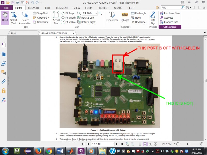

  • chika16
    0 chika16 over 8 years ago in reply to jafoste4
    Hi Josh,
    The link to the thread of discussions with Analog Devices EZ is https://ez.analog.com/thread/91929    AND
    https://ez.analog.com/message/288817?commentID=288817&et=watches.email.thread#comment-288817
    . I discussed with Di Pu, Lars and Rajeesh.image
     The green Leds on the Port are off and no connection... Only USB-serial peripheral connection works.. it boots to show digilent on OLED.
    Please i want to change the board or have it quickly fixed .. I have not implemented anything since first of Feb ..when it was delivered.
    I started telling Avnet about this from 3rd Feb .. 2 days after purchase and No one came up like you are doing now (10 days of suspense).
    Thanks.
    Please be rest assured that everything else about this board works as user guide says--HDMI, VGA, LED,OLED, SDcard etc
    I need urgent help.
    _chika
  • chika16
    Hi Jos,
    I sent email to the following:
           1.     Onlinesupportus@avnet.com
         2.   EM-WEB-ORDERS@Avnet.com
           3.    international2@avnet.com
       AND....
           4.    avnetsales@avnet.com
     No one is telling how a brand new board I got from Avnet AMERICA on the 1st of Feb. , can be replaced or Ethernet port remedied... I will handle the shipment as I did when I purchases it (75 GBP) .. my last post show that the IC net to the port heats UP.
    Please hep!!!!

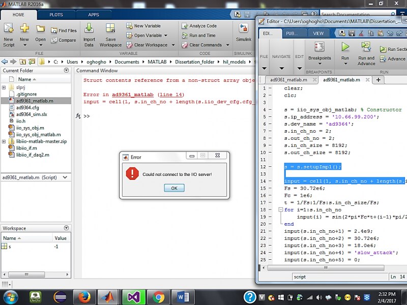

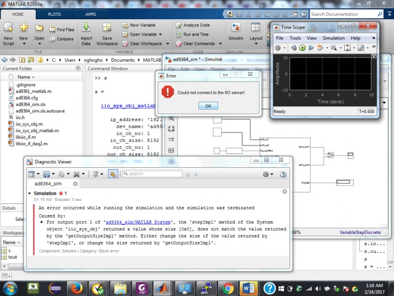

    Hi Josh,
    I am happy with Avnet replacing my board:   tey did weel 1
    I have tried to run the example again and I get:
    The new error in both cases ie MATLAB/SIMULINK is:
    “ COULD NOT CONNECT TO IIO server ”
    The model from the site is ad9364_sim.slx
    Take a look, though the script is for ad9361; I changed the s.dev_name = ’ad9364’ since my device is AD-FMCOMMS4-EBZ
    BUT
    You can see after line 12, that the S (system object) did not return the cell array expected  but -1  => S is destroyed  and it stops execution at line 14 ..
    The networking between Zedboard Gigabit Ethernet port and PC  Ethernet port is ok (a cross over cable is used and I can ping the ZB from my host PC)
    WHAT IS STILL THE PROBLEM?
    -WILLs
  • jafoste4
    0 jafoste4 over 8 years ago
    Hi Wills,
    Unfortunatly we do not have much experience here with Matlab/Simulink.
    My suggestion to you wuld be to go ask your question over on their suppor section.
    https://www.mathworks.com/
    --Josh
  • chika16
    Dear Josh,
    What is the main entry point information from your workflow? My original intention was to use libiio system_obj with simulink but from my last post you see that the iio_sys_obj in simulink or Mathlab cant connect to iiod/(TCP/UDP) on the ZEDBOARD for many at least two weeks i have been at this point.
    Please I know you are not matworks but you us ZEDBOARD even with mathlab or ADI tools..
    What is the reliable workflow from AVNETs perspective?
    -Wills
