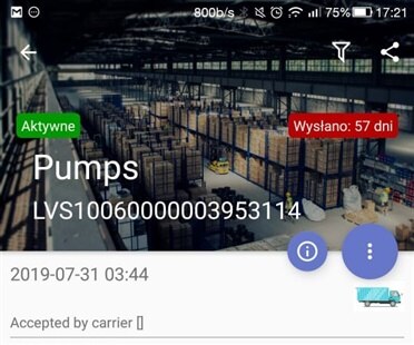

Little 5V pump from aliexpress.
Damn you chinese packages! (57 days and counting...)

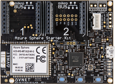

1. Take a photo of your Azure sphere devkit laying on a smooth level surface. You should end with a top-down view of a PCB. You need to do this as precisely as possible so i recommend using some sort of mount to steady your camera. I didn't have to do this because i found suitable photo right on this very site! I'll attach it for you so you can start faster.
Top down view of an Azure Sphere Devkit (full photo in attachments)
Only one dimension needed!

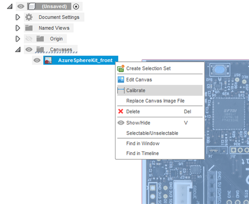

2. Open your CAD program of choice and import photo of your device. In Fusion 360 this can be done by clicking Insert > Canvas.
Now its time to calibrate your canvas. Click on your imported image nad select "Calibrate" , click on two points on your image and enter real-live measurement between those points. Volia! Now you can sketch on your photo and lines that you make should be 1:1 in scale to real life. If that is not the case you should retake your photo/use different points to calibrate.

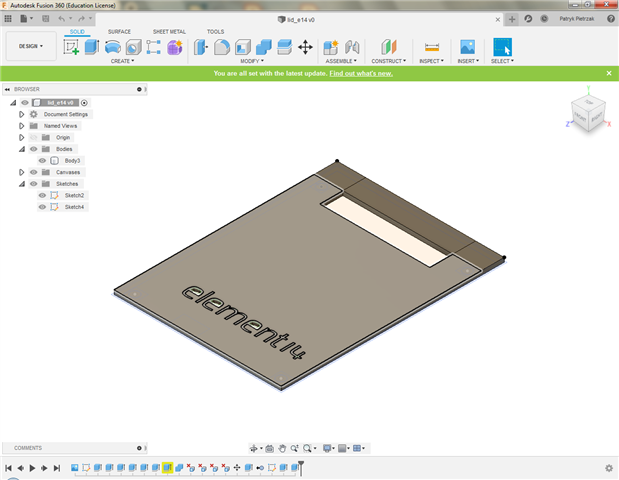

4. Now is time to extrude your creation. My design includes snap-on lid and internal standoffs. I also uploaded version without standoffs in case your 3d printer fails to print this (witch sadly was the problem in my case). For lid just use sketch that you developed earlier and extrude only parts that would make the lid (i decided to include cable hole and e14 logo that i found svg file on the internet)

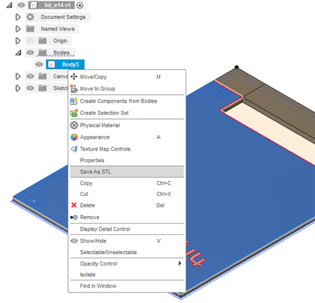

5. Now is time to save your creation to STL file by right clicking it and selecting "Save to STL". Now we are ready to slice it in your slicing software of choice and begin printing!

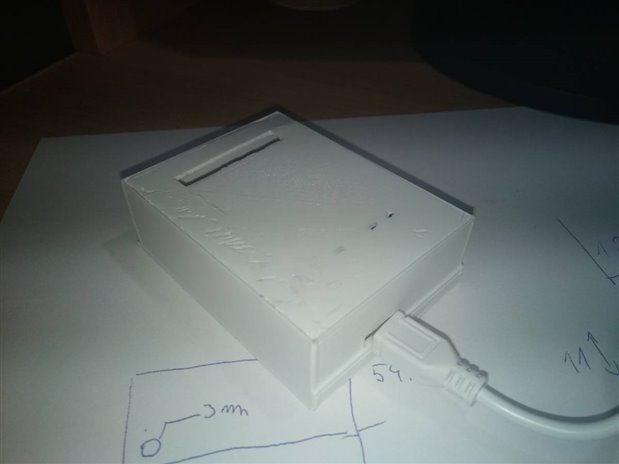

For me the printing process took most of the time. Partly because of my old ancient... piece of fine technology that is my printer, but also because my way of prototyping is based largely on trial and error. So i really recommend this only if you have spare time and you own a 3d printer yourself. If you need to have someone to print it for you i recomment taking your time with measuring and drawing to avoid unnecessary costs.
Printing in progress
Done! A little small for a snug fit... (notice layer shift at the bottom due to low tension on X axis)
I've attached my STL and Fusion 360 project files in case you want to analyse what I have done, or just want to print things.
My tips when printing cases:
- Print the bottom (box) part with 101%-103% scale to compensate for material shrinkage and printer/your hand inaccuracies. Printing at an original scale may lead to your PCB not fitting at all.
- You may leave the lid portion of case as is so you would have a better time snapping it on rest of your case.
- Recommended valuses for my stl are: 20% infil, no supports and 0.2-0.3 layer height.
- Print "Body_standoffs" file only when you are confident in your printer, standoffs may end up too big/deformed if you have big nozzle diameters/extrusion multipliers.
103% scale, no standoffs. Fits perfectly!
With lid attached. Printed with PET-G filament (notice that due to overextrusion on my side element14 logo printed incorrectly)
