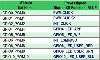

Nine GPIOs with PWM functionality are accessible on the Avnet Starter Kit. See the table below.
eg. The utility and visual effectiveness of the five user-controlled LEDs (on GPIO4, GPIO5, GPIO8, GPIO9, GPIO10) can be enhanced by implementing PWM control of these GPIO outputs

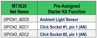

Three GPIOs can be configured as ADC analog input pins on the Avnet Starter Kit:
ADC resolution is 12 bits. Maximum sample rate is 2 MHz.

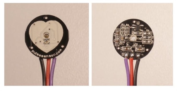

    I am trying to connect a Heart Rate Sensor that I have from another project.
    This project used the Raspberry PI and an ADC on a breadboard connected to the Raspberry PI.
    I would like to attach this sensor directly to the Starter kit, but can't figure out where to hook the three leads coming from the Heart sensor.
    the original project Is on Hackster.io at
    https://www.hackster.io/mohamedemam0/windows-10-iot-core-reading-heart-rate-pulses-e3af03
    Here is some information about the project from the link.
    I did get this working with IoT Core about a year ago and thought it would be a good project to try and connect it to the starter kit.
    Heart Rate Sensor
    • BLACK: Ground
    • RED: Input: +3V or +5V
    • PURPLE: Signal
    So, we need to connect the signal coming from the sensor to one of the channels in our ADC. To know how to connect the ADC, here's a scheme of our IC to know the function of each leg. (I got it from the datasheet of the IC, you can google it):
    Schematic
    https://hacksterio.s3.amazonaws.com/uploads/attachments/305795/scheme_MCIspTCn0i.png
    Any advice would be really helpful, I am a developer that has a limited knowledge about electronics.

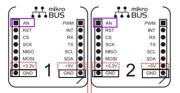

    skruglewicz Steve, you can connect it like this:
    Not sure what is the maximum voltage on this sensor output, but I'd expect it to be close to Vcc. I'd use 3,3V for powering the sensor then.
    If you plan to use RLCore (M4) app, AFAIK there's no information on how to set ADC reference voltage to something else than 2,5V and signal maximum measurements may get clipped. If you want to get really exact data, you'd have to use a simple resistor voltage divider between sensor output and AN input.
    HLCore (A7) apps allow setting ADC reference voltage, but it is not clear what the allowed values are, so I can't comment on that.
  • peterfenn
    peterfenn over 6 years ago in reply to jgroman
    Specifications for MT3620 device limit the ADC input range to be from 0V to VREF
    VREF is the external voltage reference input (accessible via header on the Starter Kit) and should be 2.5V or 1.8V
    (2.5V is the maximum voltage for ADC inputs)
  • peterfenn

    Thanks Peter
    Does this seem like a viable connection?
    In collaboration with jgromanreply to my initial comment on the Heart Rate Sensor.
    I'm still not clear on the RED input the project calmed " RED: Input: +3V or +5V"
    I don't want to harm the the starter kit.
    So from your information I need to:
    1. Use the +5v header for the RED sensor wire.
    2. And place a simple resistor voltage divider between sensor output and AN input. (to cut the voltage to 2.5v)
    I will use the  A7 core to access the ADC and use "ADC_SetReferenceVoltage" Function to set the voltage to 2.5 v
