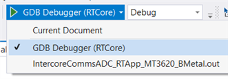

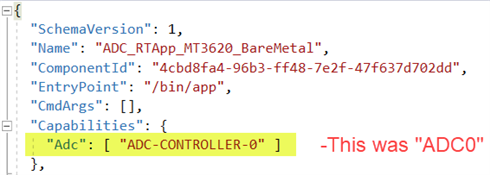

    Having updated to 19.09, I am now getting "Real Time Core: ERROR" on the screen of the OLED when running the code used in your Advanced Tutorial (and no light readings obviously). I don't think anything else has changed. Do I need to recompile everything, or does the code need to change, following the firmware update?

    This is because the RTApp was previously built using a Beta API set (2+Beta1905) that has now been deprecated and is not supported by the 19.09 OS
    To correct this requires the following:
    • Two files need to be edited (app_manifest.json and CMakeSettings.json), then
    • The RTApp needs to be rebuilt, targeting the later 3+Beta1909 API set that is supported by 19.09 OS
      (at this time RTApps are only supported by Beta API sets, not the LTS API sets)
    Please use the following procedure to update your RTApp project:
    1. In app_manifest.json: Change the name of "ADC0" to "ADC-CONTROLLER-0"  then press Ctrl+S to save this file
    2. The CMakeSettings.json file requires a number of edits. Easiest is to simply copy an updated CMakeSettings.json file from the 1909 version of  \Samples\ADC\ADC_RTApp_MT3620_BareMetal (into your source folder of your broken RTApp, overwriting the file of same name that is there)
    3. Now execute a CMake / Clean All, followed by CMake / Build All
    4. Select GDB Debugger (RTCore) from the dropdown (Startup item) list, then press F5 to program the device and launch the debugger
