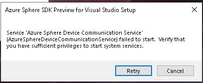

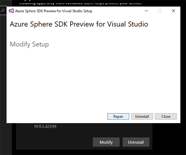

1. SDK Installation (TAP-Windows wont install! Therefore 'Azure Sphere Device Communication Service' wont start!)

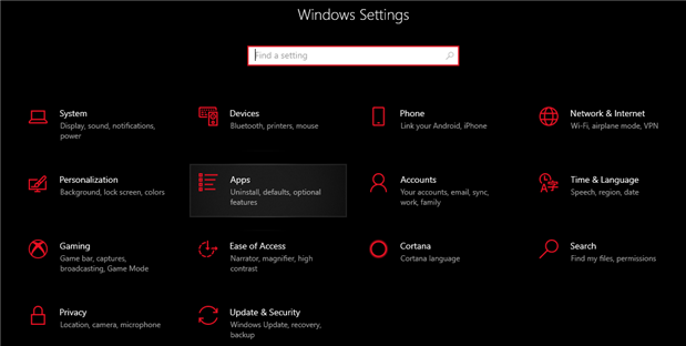

Follow the steps below -
- Click cancel here

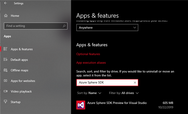

- Go to Windows 10 settings and click on Apps
- Search for Azure Sphere SDK in the search bar shown here
Click on  'Azure Sphere SDK Preview for Visual Studio', you'll find two buttons Modify and Uninstall. Click on Modify! Then wait for some sesconds until you find such a windows with these options Repair, Uninstall and Close.
Click on Repair and then wait for some minutes! Voila! You did it! And it works again like new!

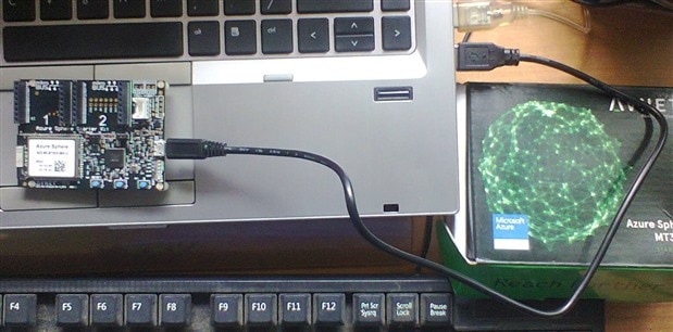

- If your green light is seriously OFF!

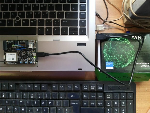

- Remove the USB cable keep it aside.

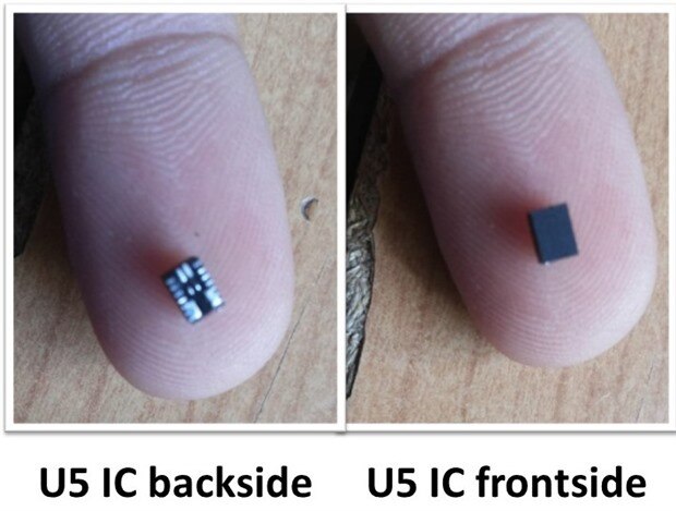

- Find the U5 component on the board. A simple looking miniature black IC. Situated between C8 and C10, left to C3, above C9. BEST OF LUCK finding the regulator! image
(Can you see a place with no IC and just some soldier points this was the place where U5 IC sat! GOT MUM'S PHONE!)
- Removed / Popped out U5

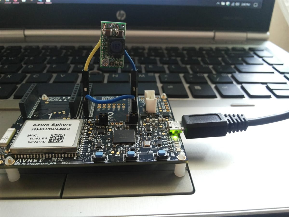

- Okay now when you find the component again connect the board or power the board, use a multi meter to check the power supply across the component. If you don't have a multi meter like me, go to a nearby mobile or computer repair shop and ask them to help in checking the component in and out voltages if you see a NO out from the IC you successfully found that the IC is damaged.

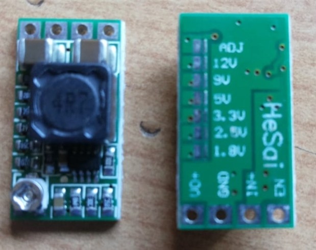

- Now go home and buy a replacement for your board or buy a 5v to 3.3v 3A step down regulator. I had brought -> https://www.amazon.in/gp/product/B07G26ZYB8 . You can find the same thing in Amazon.com and other online shopping marts! image
*- Now after receiving the replacement regulator, get a Hot Air Gun or a Heat Gun to remove the damaged component from the board, am not sure what would happen if we do the connection without removing the damaged component. But its safe to remove the component someone in Hacster.io said that other components in te board may get damaged due to this single component. If you don't have a Heat Gun or Hot Air Gun like me, go to a nearby mobile or computer repair shop and ask them to carefully remove the small component carefully.
- This is how my regulator looks like! (VO+ and IN+ are the important pins to look for!)
- Now follow the connection diagram for the new regulator!
- Do the connections accordingly.
- Seems that some LDO (Low-dropout) boards have wrong silkscreen marks (voltages displaced and so on...), check always the output voltage before connecting to the Azure board!
- Also adjust the potentiometer carefully after installing it to match 3.3V with the current the board is drawing.
- Be sure of the max current output of the LDO you are using, WiFi has big peak current demand when transmitting!

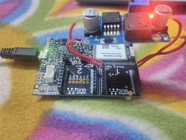

This is what I did to resurrect my board!
{gallery} WORK DONE!
The single BLUE wire jumps GND! Yellow is my VO+ and Blue is my IN+.
Thank You! mvp  He had helped in first replacing the regulator!
davidlr helped in finding out some LDO Regulator Issues!

    Thank you very much. You are a lifesaver. When my device stopped working, I got really frustrated and was about to throw it away. Then I saw this post. Then I gave my azure sphere to a mobile service center where they had some equipment (they called it blower) through which they removed this U5 component. I bought an adjustable buck converter and connected its input side to 5V and GND on the azure sphere. Then I set the output to 3.3V via the potentiometer on it. Then connected it to the 3.3V and GND on the azure sphere.  I did exactly like what you said and now it's working like a charm.image
