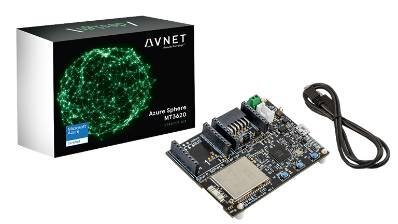

The Azure Sphere MT3620 Starter Kit 2.0 is an enhanced version of Avnet’s popular Azure Sphere Starter Kit. It supports rapid prototyping of highly secure, end-to-end IoT implementations based on Microsoft Azure Sphere. This small form-factor carrier board includes a production-ready MT3620 Sphere module with WiFi connectivity, along with multiple expansion interfaces facilitating easy integration of sensors, displays, motors, relays and more. Key features of this version are its ability to support a wired Ethernet network connection (requires MikroE ETH click adapter to be fitted) as well as more flexibility in how ISUs can be used. Downloadable documentation and tutorials guide developers through all steps, from board setup to application coding.
Features:
Carrier Board 2.0
  • Azure Sphere MT3620 Module
    • 2.0 (dual-band WiFi)
  • Two MikroE click board expansion sockets
  • Grove expansion connector (configured as I2C)
  • On-board sensors
    • 3-axis accelerometer and gyro
    • Ambient light sensor
    • Temperature (die not ambient)
    • Pressure/barometric sensor
  • Interface for optional OLED 128x64 display
    • USB-based program/debug & recovery interfaces
  • User push button switches and LEDs
  • 5V to 3.3V power regulation
  • DC supply inputs:
    • USB 5V from host computer
    • External 5V via terminal-block
    • VBAT supply from optional coin-cell battery
Azure Sphere MT3620 Module 2.0
  • MT3620AN SoC multicore device
  • 1x 500MHz Arm Cortex A7, 4MB SRAM
  • 2x 200MHz Arm Cortex M4F, 64KB SRAM
  • 3x ISU interfaces (configured as UART, SPI, I2C)-ADC/GPIO: 3x 12-bit
  • ADC inputs (or 3 GPIOs)-PWM/GPIO: 9x PWM outputs (or up to 24 GPIOs)
  • RTC: Requires coin cell battery for VBAT voltage
  • Wi-Fi: Dual-band 2.4/5GHz 802.11 b/g/n radio
  • Antenna: Dual-band 2.4/5GHz chip antenna.
