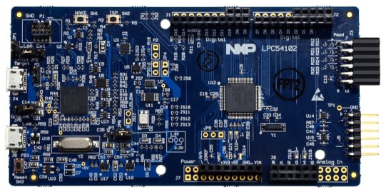

The LPC54102 is a member of the LPC54100 family of devices, integrating two 32-bit ARM cores. Targeted for low power applications, this device is optimized for the lowest power consumption in active mode and also provides excellent power numbers in stand-by and power-down modes.
The two cores, a Cortex-M4F and a Cortex-M0+, can work independent of each other or team up to work on shared tasks.

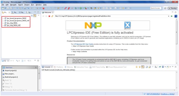

Import the required LPC chip and board library project
You need to import the required chip library project and LPC board library project from “C:\nxp\LPCXpresso_8.1.4_606\lpcxpresso\Examples\LPCOpen\lpc5410x_lpcxpresso_54102_lpcxpresso_3.01a.zip”
  1. lpc_board_lpcxpresso_54102
  2. lpc_board_lpcxpresso_54102_m0
  3. lpc_chip_5410x
  4. lpc_chip_5410x_m0

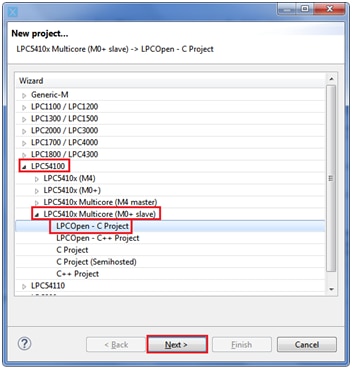

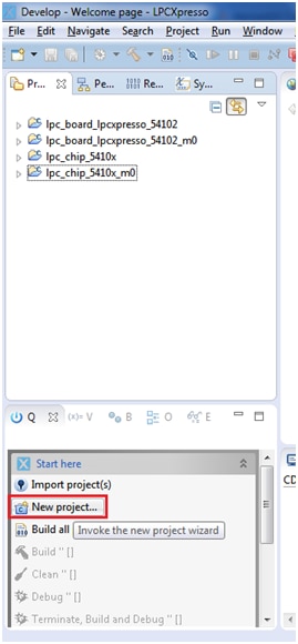

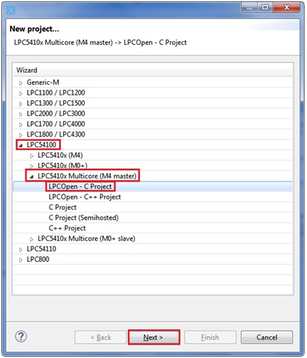

Click on New project from quickstart panel
Select LPC5410x Multicore (M0+ slave) from New project window as shown:   And ‘LPCOpen - C Project’ need to be selected.

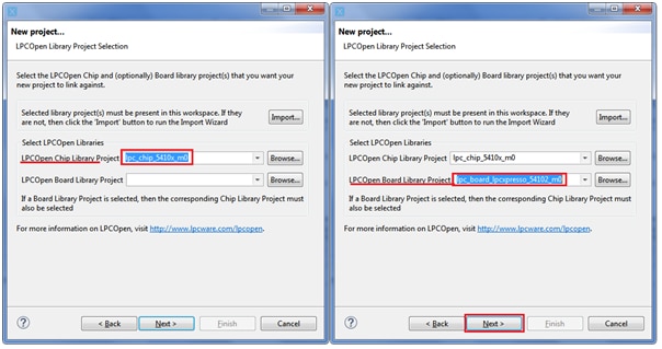

Enter project name of your choice i have selected as “example_M0+_slave”
Next select appropriate chip library and board library for the M0+ i.e lpc_chip_5410x_m0 and lpc_board_lpcxpresso_54102_m0

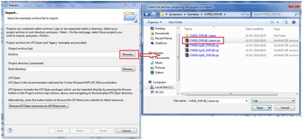

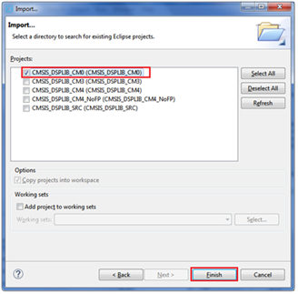

Import CMSIS_DSPLIB_CM0 library
Next import CMSIS_DSPLIB_CM0 lib as shown below:
Select the path “C:\nxp\LPCXpresso_8.1.4_606\lpcxpresso\Examples\CMSIS_DSPLIB”
Click Next
After selecting DSPLIB_CM0 proceed further by clicking Next

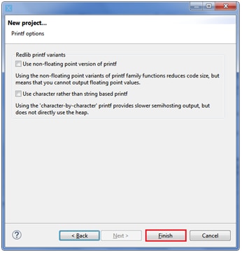

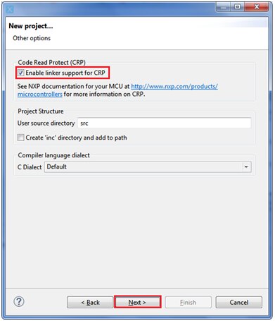

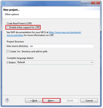

On 'Other options', ensure Code Read Protect (CRP) is unticked

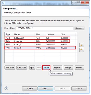

Setting Memory configuration for slave project

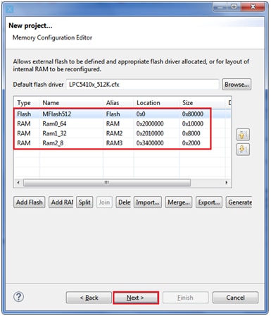

On the Memory Configuration Editor page, you should see the various memory blocks defined by default for the target MCU.

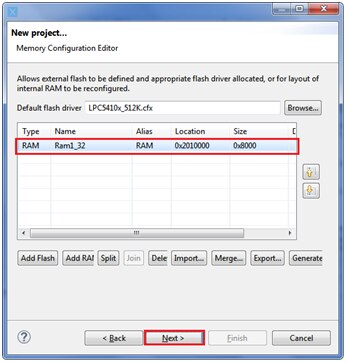

We need to modify the default memory map to only use the memory that will be used by the Cortex-M0+ (rather than the Cortex-M4).
Only Ram1_32 should be retained
Then click finish to create the slave configuration project:

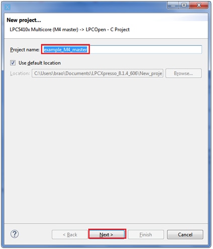

Create master project
Click on New project from quickstart panel as we did earlier
Create new project by entering name of your choice: “example_M4_master”

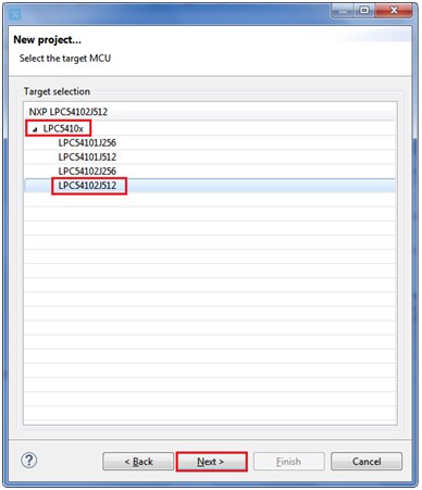

Select the required target MCU, say LPC54102J512, and click Next.

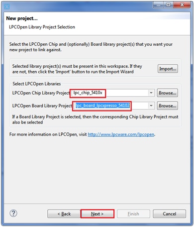

On the LPCOpen Library Project Selection page, select the LPC5410x chip library for the M4, say lpc_chip_5410x, and then the appropriate board library, for example lpc_board_lpcxpresso_54102, and click Next.

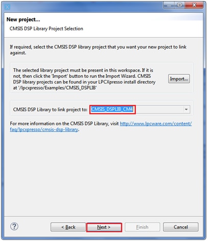

Import CMSIS DSP Library for CM4 core
Click Next through CMSIS DSP Library selection and Part specific options pages.
Proceed further by clicking next on other windows option and On 'Other options', ensure Code Read Protect (CRP) is ticked.

On ‘Memory Configuration Editor’ leave the memory definitions as per the default.

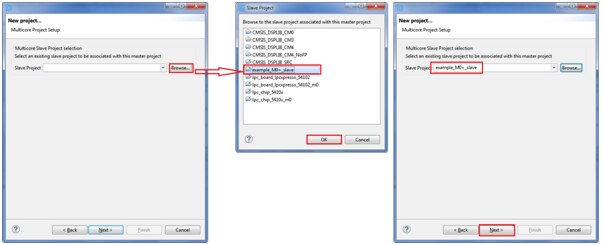

On 'Multicore Project Setup' page, use the 'Browse' button in the Multicore Slave Project selection box to select the Multicore M0+ project that you created previously:
Click finish

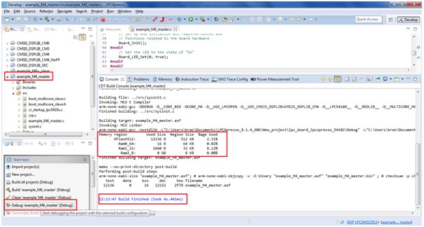

Start a debug session for Master project using the Debug option in the Quickstart view.
Click on Debug option as shown below:

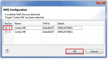

Select the emulator and SWD configuration for master Cortex-M4
Now select the emulator LPC-LINK2 CMSIS-DAP as shown below:
Next select the SWD configuration devices as Cortex-M4 as shown below
Having selected the appropriate core, LPCXpresso should download the executable containing both the Master and Slave images into the target MCU flash memory.

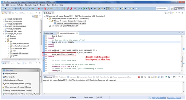

Add breakpoint inside master.c and resume the debugging process

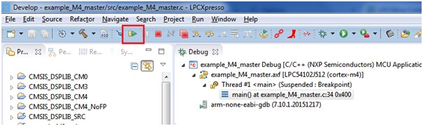

Once the connection has been made, you should hit the default breakpoint at the start of main() in the Master executable :
Click on Resume button as shown below:
The execution will come and wait at “boot_multicore_slave();”

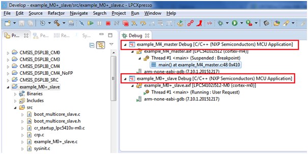

Now there are two debug sessions available as shown below:

You can now debug both cores in parallel, selecting which core to step, resume, suspend, etc by switching between them in the Debug View.
Note: Although there is no debug logic synchronising debug operations on the two cores, you can select both applications at the same time in the Debug View (typically by using CTRL-Click) and operations like step, resume, suspend, etc will then be carried out on both cores by the debugger in parallel.
The currently selected core will be the one used for displaying many of the debug related views, such as Registers and Locals. It is also possible to create copies of many of the debug related views, and lock each copy to a particular core.
