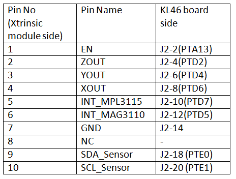

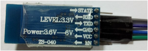

Connect the Bluetooth module HC-05 to the board header as shown below:
imageConnect the xtrinsic sensor board to the KL46 board as shown below:

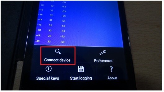

1)     Open the Blue term app from the mobile as shown below:
2)      Connect the blue term with the HC-05 BT device as shown below:

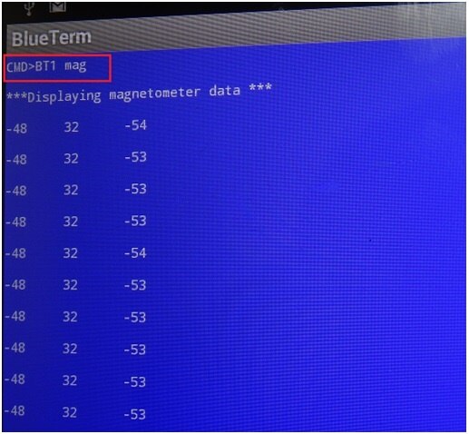

3)      Type a command to execute and get the sensor data
The commands to be given are shown below:
1)      “BT1 accel”
2)      “BT1 mag”
3)      “BT1 press”
4)      “BT1 help”
