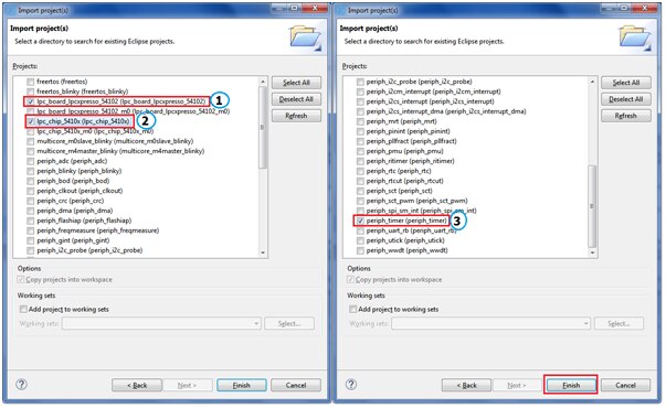

Open LPCXpresso tool and select the workspace location of your choice:
Select import project from quick start panel as shown in below picture
Now you need to point on the location where LPCOpen example for LPC54102 is present i.e
“C:\nxp\LPCXpresso_8.1.4_606\lpcxpresso\Examples\LPCOpen “
Below picture shows selecting import project from LPCOpen directory
Click on Next button as shown:
Now select the libraries required for the project execution (these two libraries has to be selected else your project will not compile)
“lpc_board_lpcxpresso_54102(lpc_board_lpcxpresso_54102)”
and
“lpc_chip_5410x(lpc_chip_5410X)”
And select example project “periph_timer” which is LPC5410x Simple timer example
  The selection is as shown below:
Now your workspace looks as shown below:

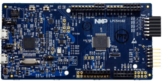

By default, the LPCXpresso54102 is configured to use the on-board debug probe (Link2) to debug the on-board target (LPC54102), using the CMSIS-DAP debug protocol pre-programmed into the Link2 Flash memory. The factory default CMSIS-DAP Link2 image includes UART bridge functionality
Default Jumper pin positions
Jumper JP1 :
Jumper JP1 is in open (default) the LPC54102 Target SWD interface enabled.
Jumper  JP2:
Jumper 1 – 2 (default) when on-board LPC54102 Target is connected to either the on-board Link2 debug probe or an external debug probe.
Jumper JP5 :
Link2 (LPC43xx) force DFU boot – 2 position jumper pins.
Jumper JP5 open (default) for Link2 to follow the normal boot sequence. The Link2 will boot from internal flash if image is found there. With the internal flash erased the Link2 normal boot sequence will fall through to DFU boot.
Note that the LPCXpresso IDE can also be used with redlink protocol by booting the Link2 in DFU mode, by installing a jumper on JP5
Now connect usb cable to J6 connector which is named as ‘Link’ on your board (refer to above fig) and click on the Debug option in “quick start panel’ as shown below:
