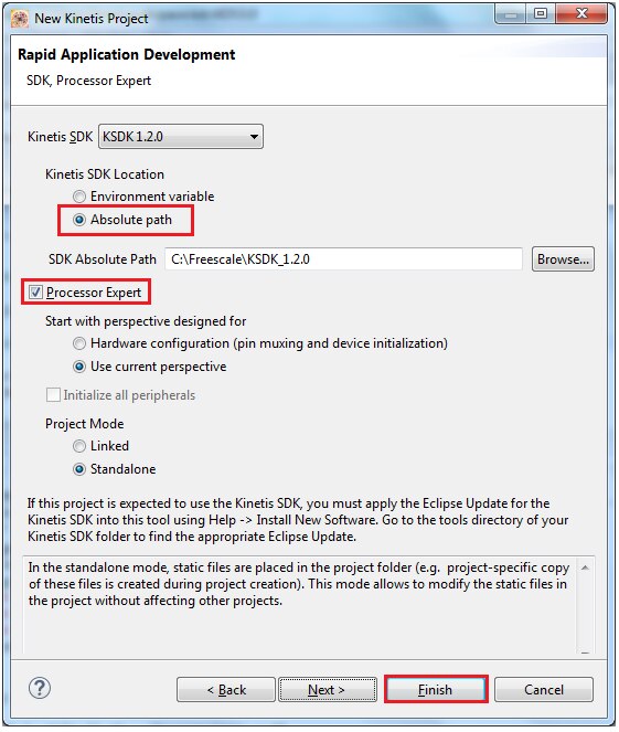

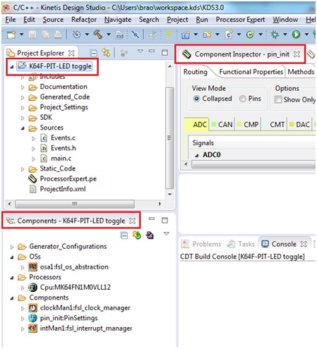

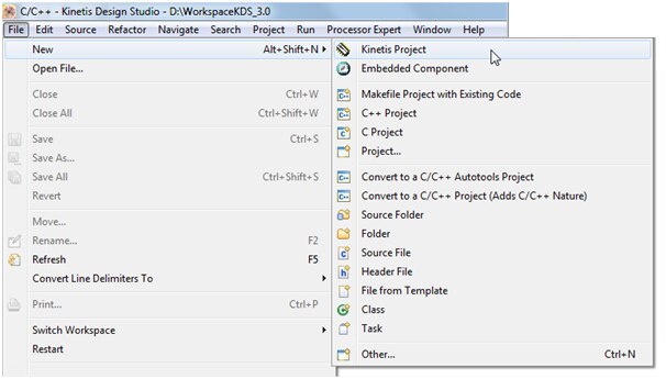

Create new project
Create new project in KDS 3.0 with KSDK 1.2.0
Type the project name e.g.” K64F-PIT-LED toggle”, choose the board FRDM-K64F, mark off options Kinetis SDK and Processor Expert

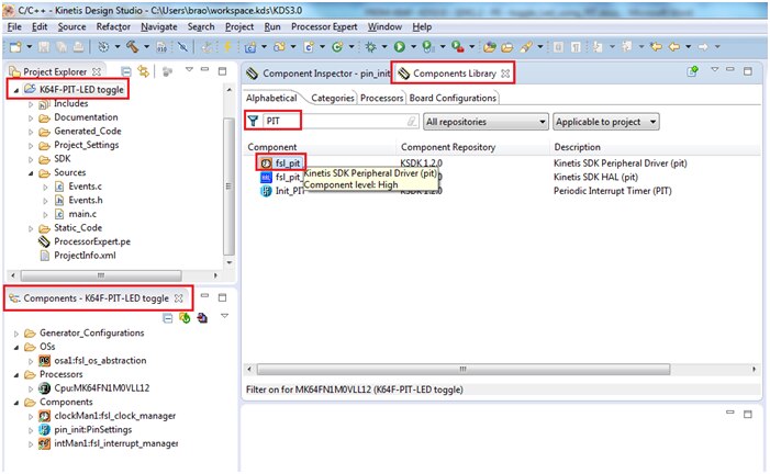

Now, your project structure looks like this in the project explorer and Processor Expert windows:
Set Processor Expert Settings

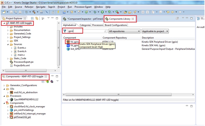

Now, go to Components Library, find fsl_pit component using filters KSDK 1.2.0 and Applicable to Project and by double click add the component to the Processor Expert Component View of your project.
Similarly search for gpio and select fsl_gpio component which is required for toggling LED as shown below:

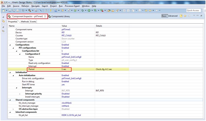

Double click on fsl_pit module from components windows and Component Inspector view should open automatically
First turn the Component Inspector view to Classical view by unselecting the Tab View option.

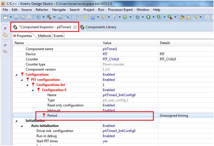

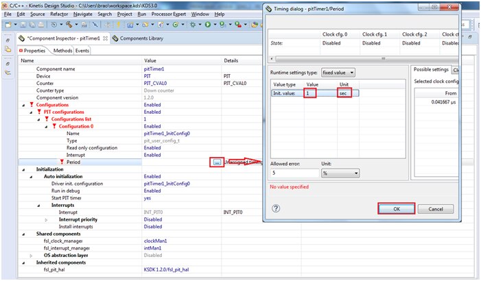

Configure the PIT module and click on “Period” option under configuration section as shown below:
Change the value to 1 sec by clicking on button ...image
Now all the red markings will vanish which indicates it is error free

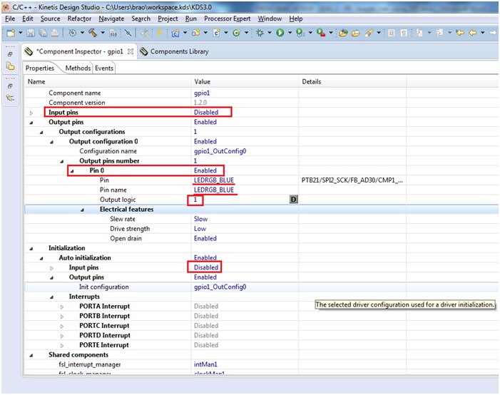

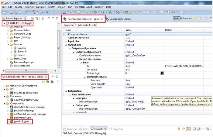

Now double click on the fsl_gpio module it looks like below:
Make the settings as shown below:
i.e disable the input pins,
output pin 0 is configured to LEDRGB_BLUE port pin PTB21 which is connected to blue LED

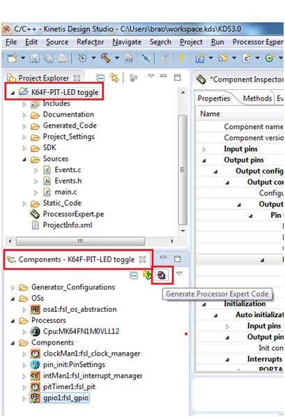

Now all our modules are ready assigned, we need to generate code by pressing the generate icon as shown below:
You can see all the required files will get generated under Generated_Code folder inside project folder.

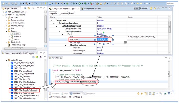

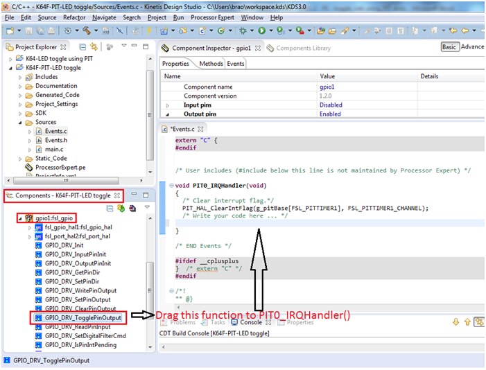

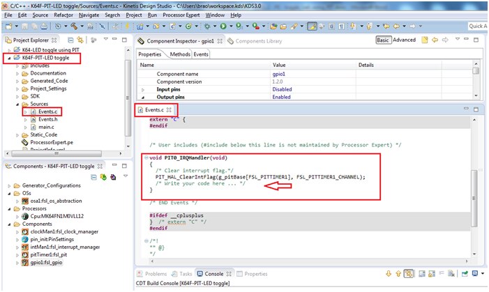

Now it’s time to include our task inside the PIT IRQ. The ISR can be found in Events.c file as shown below:
Now we are inserting the toggling function inside PIT0_IRQHandler()
The toggling function can be found from components window inside fsl_gpio module as shown below:
The function GPIO_DRV_TogglePinOutput(uint32_t pinName); accepts the parameter uint32_t pinName this can be found from the assigned name for blue led gpio we assigned in component inspector of fsl_gpio as shown below:

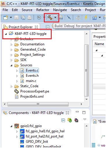

Build your project by choosing the right toolbar shortcut

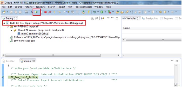

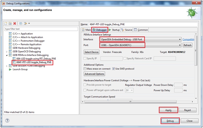

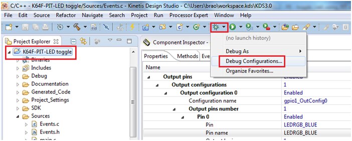

Debugging the FRDM-K64F board for the first time, you need to define a Debug Configuration by selecting the appropriate option from the toolbar
For this example, we are going to select the PEMicro OpenSDA Debug mode.
Select the Debugger tab to choose the Interface OpenSDA Embedded Debug - USB Port
You can now start the Debug session!!
Launch the configuration
You should now able to see the Blue LED blink with a 1Hz frequency i.e for every 1 sec of PIT interrupt the LED toggles.
