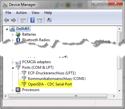

When I ported FreeRTOS to the Freedom board, I noticed that the OpenSDA debug interface enumerated as well a USB CDC port. After I had explored the P&E OSBMD/OSJTAG virtual serial port, I wondered if this works as well for my Freedom board. And yes, it does!
OpenSDA CDC Serial Port in Task Manager

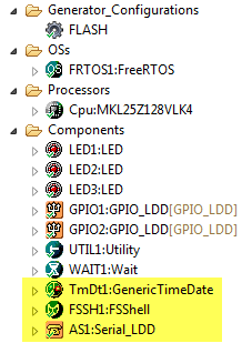

The Application
The application is implemented with Processor Expert in Eclipse based CodeWarrior for MCU using the ARM gcc compiler:
Freedom Shell Application with Processor Expert Components
Compared to the application in this post, it ads:

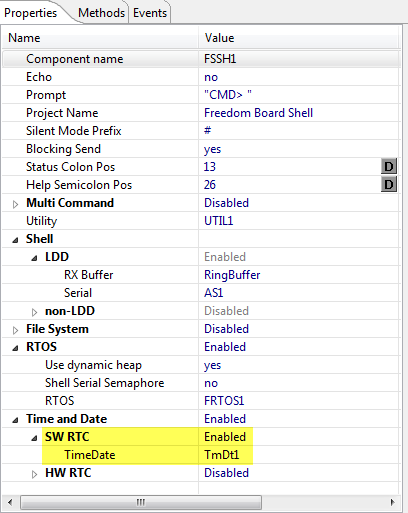

  1. GenericTimeDate: A generic real-time clock implementation, see There is a Time and Date for both Worlds.
  2. FSShell: A file system shell with command line interface. See FatFs with Kinetis.
  3. Serial_LDD: Logical Device Driver for a serial/UART connection.

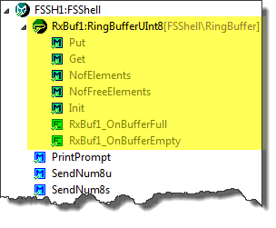

FSShell with RingBuffer
Developing the Application for the Freedom board, I used that opportunity to refactor the FSShell component a bit: the component was using its own buffer management. Having a more universal ring buffer implementation in RingBufferUInt8, I decided to use for the FSShell as too:
FSShell with Ringbuffer
Additionally I have added a new routine ReadAndParseLine() an ‘append’ buffer management. This is useful if the terminal is sending character by character (and not as a full string). It turned out that this was a good idea if using Tera Term.

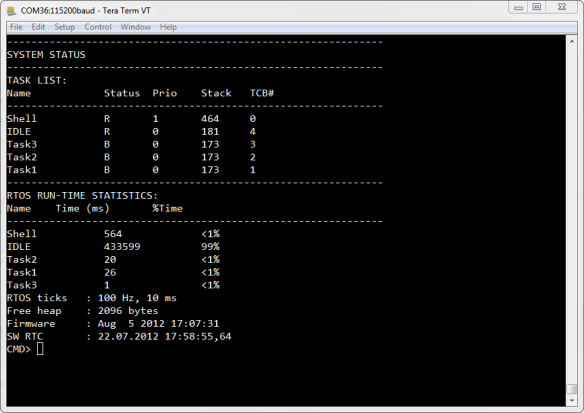

Tera Term: USB CDC with OpenSDA
Trying my application did work right away: both the Eclipse Terminal view and Termite had problems: the were blocking after few seconds :-( . Not sure if this a generic problem of the terminal implementation or the OpenSDA USB CDC implementation. Luckily it worked perfectly with Tera Term :-) . So that’s why I’m showing Tera Term screenshots below.
After reset, the board shows the following menu. The same menu is shown if I type in ‘help‘ as command:
Freedom Board Shell
Date and Time commands are provided automatically through the FSShell:
FSShell with TimeDate
Date/Time and other information is shown with typing the ‘status‘ command:
System Status
This shows me as well all RTOS tasks with their status, along with performance information about each task.
