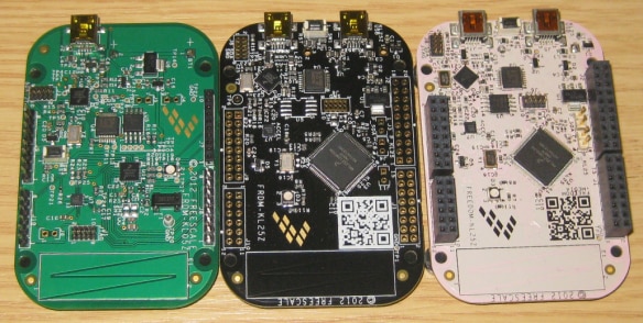

The board is available for pre-orders at element14 and has the same size and shape as the FRDM-KL25Z.
3 Freedom Boards (green: new FRDM-KL05Z, black ‘production’ FRDM-KL25Z and white ‘preproduction’ KL25Z board)
The KL05Z features the KL05Z processor from the KL0 family, which is the smallest and tiny brother of the KL2(5Z).

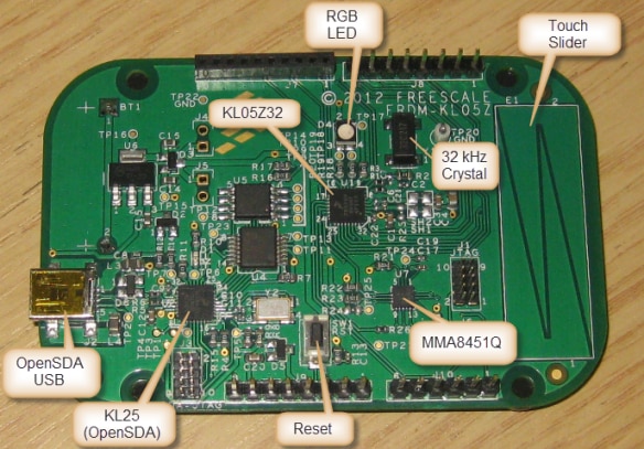

The board includes the MMA8451QR1MMA8451QR1 accelerometer, a reset button, a RGB LED and touch slider area, similar to the FRDM-KL25Z.
FRDM-KL05Z Board
The differences are shown best in a comparison table:
FRDM-KL05ZFRDM-KL25Z
CPUKL05Z32 (QFN32), ARM Cortex-M0+KL25Z128 (LQFP80), ARM Cortex-M0+
FLASH32 KByte128 KByte
SRAM4 KByte16 KByte
CRYSTAL32 kHz8 MHz
USBnoyes
Arduino HeadersSingle (not populated)Dual (not populated)
RGB LED yesyes
Touch Slider yesyes
AccelerometerMMA8451QR1MMA8451QR1MMA8451QR1MMA8451QR1
USB OpenSDA Debug yesyes
Kit Content Board onlyBoard only
PriceEuro 9.10Euro 9.10Euro 10.37Euro 10.37
Note: my board has the Arduino and the JTAG headers (both for the OpenSDA and for the KL05) populated. I expect that the final board (as the KL25Z) will *not* have these headers and battery holder populated. See this post about possible parts to populate the board. My board has as the ‘white’ KL25Z boards U5 with an external EEPROM populated, while I expect that this part will not be present on the final boards (as on the black KL25Z). The picture on element14 site even does not show the U5 footprint any more.

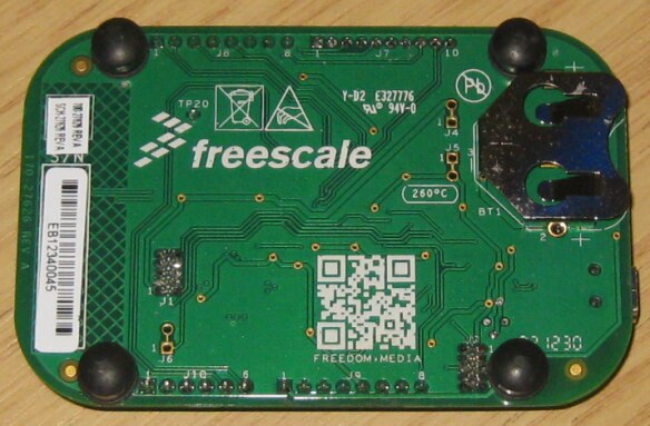

FRDM-KL05Z Board Backside
Note : The KL25Z board has a 8 MHz crystal which is needed for USB operation. Such a 8 MHz crystal usually draws more current than a 32 kHz one as found on the KL05Z. So I would expect that the FRDM-KL05Z board woudl be more ideal for low power applications. But at the price of not having a USB port for the microcontroller. Still the OpenSDA USB port can be used e.g. for USB CDC (serial/terminal) communication.
Similar as the ‘big brother’ Freedom board: there are three jumpers/headers (J4, J5, J6) available for power measurement or to isolate the OpenSDA JTAG clock from the KL05Z.
Note : As small detail: the mounting holes are slightly different compared to the KL25Z. The ones of the KL25Z do not match exactly to the Arduino shilds I have, and the one of the KL05Z have the same issue. Not a big deal, but having difference to the KL25Z seems odd to me.
My board is labeled as Rev X1, and the parts on the board are slightly differently located than on the picture on the element14 site: such as on my board the reset button is nearby the J9, while on the element14 site picture it is placed nearby the USB connector (which is a better place in my view).
