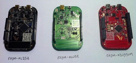

The board is orderable at element14element14 and has the same size and shape as the FRDM-KL25Z and it is compatible with Arduino R3 shields
3 Freedom Boards (black: FRDM-KL25Z, green: FRDM-KL05Z and red: new FRDM-K20D50M)
The FRDM-K20D50M features the K20D MCU based on an ARM Cortex-M4 @50MHz from the K20 family, which is the big brother of the KL25Z embedding also an USB controller.

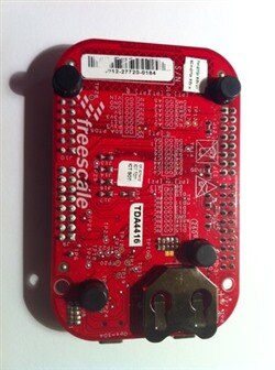

Note: my board has the Arduino and the JTAG headers (both for the OpenSDA and for the K20) populated. The 'production' board (as the KL25Z) will *not* have these headers and battery holder populated. See this post about possible parts to populate the board. My board has as the ‘white’ KL25Z boards U5 with an external EEPROM populated, while this part will not be present on the final boards (as on the black KL25Z). The picture on element14 site even does not show the U5 footprint any more.
FRDM-K20D50M Board Backside
Note : The FRDM-K20D50M board like FRDM-KL25Z board has a 8 MHz crystal which is needed for USB operation. Such a 8 MHz crystal usually draws more current than a 32 kHz one as found on the FRDM-KL05Z board. So I would expect that the FRDM-KL05Z board would be more ideal for low power applications. Still the OpenSDA USB port can be used e.g. for USB CDC (serial/terminal) communication.
Similar as the ‘small brother’ Freedom board: there are three jumpers/headers (J4, J5, J6) available for power measurement or to isolate the OpenSDA JTAG clock from the K20D50M.

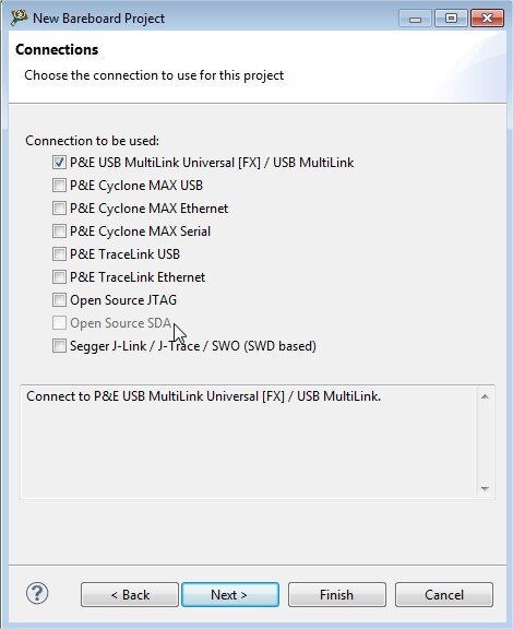

The K20DX128VLH5 microprocessor is supported by CodeWarrior for MCU10.3 out of the box but the OpenSDA debug interface will be accessible thanks to a the patch 1.0.0 that will be released March 22nd.
K20DX128 in the New Bareboard Project Wizard
Debugging will work exactly like on the FRDM-KL25Z with the OpenSDA interface.
  OpenSDA debugger in the New Bareboard Project Wizard
Even if I could not evaluate the OpenSDA debugger, Processor Expert components worked well. As for the KL2 family, ARM GNU gcc is used for the K20 family of processors.
